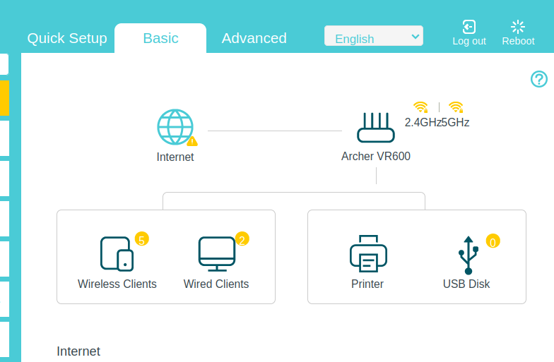

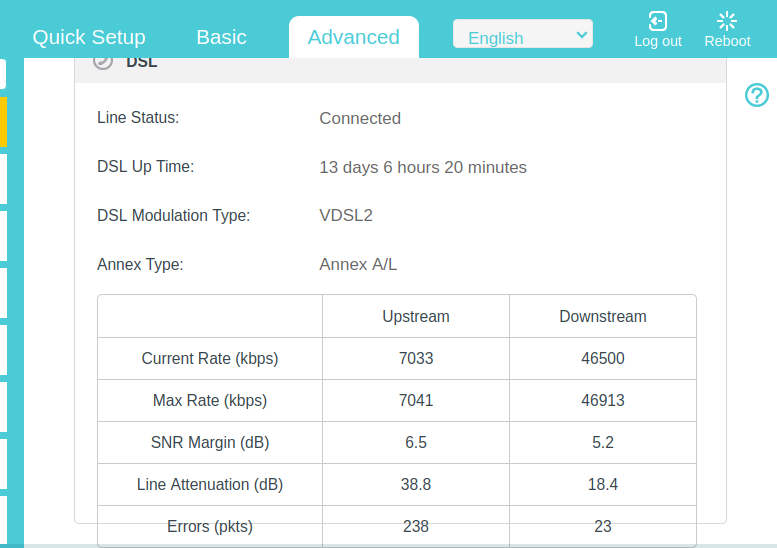

Has anyone else seen this on their VR600?
There is no internet connection, usually have to reboot as disconnect doesn't work. Detailed screen says I'm connected but the summary screen says I'm not
This usually happens overnight .

The first "screen" is the connection to the cabinet, the second is whether "the internet" is accessible.
My experience of this is that a change of PN gateway corrects the problem - using "advanced - network - internet" "disconnect" is usually sufficient for me though a reboot is sometimes needed (but I know not why!).

OK so basically the connection is there to the cabinet but somewhere along the line the connection has dropped- I assume due to maintenance being carried out.
The annoying thing is that obviously once it's dropped it doesn't recover....
