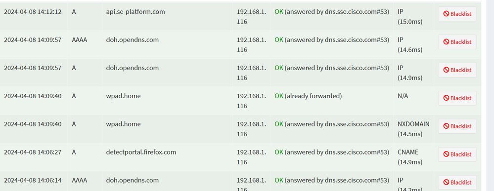

Being bored and looking for a little project I have bought a Raspberry Pi Zero 2W and installed Pi-hole on it. This is working fine and has also enabled me to eliminate the irritating adverts from organisations that I will never use that clog the top of web searches.
Looking at the Pi-hole stats I have found a couple of mysterious new wireless connections, neither appear in the list of devices in the Hub 2 Advanced/My Network list of devices. I have the Pi-hole DHCP server switched off.
One of these mysterious connections seems to be a list of every DNS lookup. Is this a 'feature' of the Pi-hole or is there a back door link of which I am unaware reporting my every move?

Where exactly are you seeing these 'connections' and how do you know they are wireless?
I'm familiar with Pi-hole but am struggling to visualise what it is you're referring to.

Ah. perhaps they are not wireless, my assumption, as I know that they are not wired.
When I go to the Pi-hole Dashboard they appear as local IP addresses under 'Top Clients (Total)' with an IP address that does not appear in the list of Hub 2 devices, either active or disconnected. Opening the address gives me, for example:

Few of those lookups are to a DNS over HTTPS server.
Can you see the IP under Tools > Network, and if so, does the corresponding hardware address offer any clues?

Thanks Bob,
Tools/Network showed me the answer.  It was a bit of finger trouble plus being fooled by my IPhone having different MAC addresses for the wireless bands.
