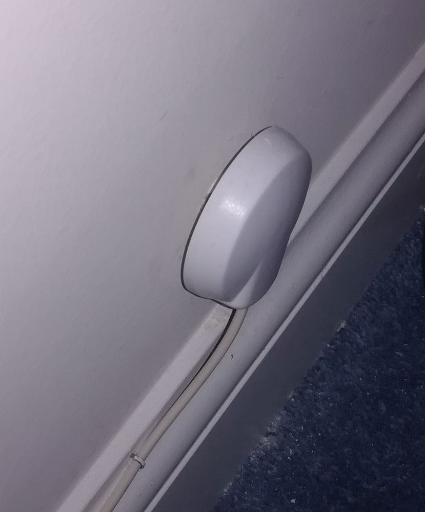

@Dan_the_Van
This is my incoming fibre cable installed late 2017.
I would consider moving the ONT if your'e happy with the cable being stapled to the wall. Speak to the installer on the day.
