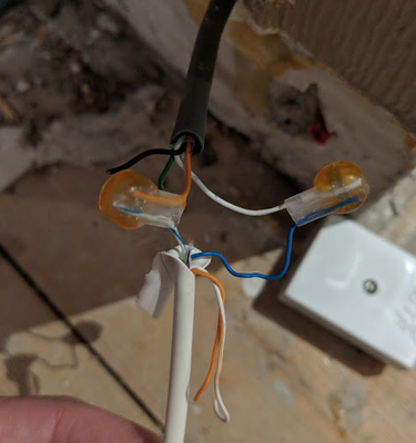

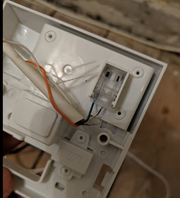

Back to square one Embarrassed
Scratching my head as to why not working - intermittent/low speed. No dial tone.
I have wired Blue (from line) into Blue (new wiring) which ends up in socket B. And Orange (from line) into White/Blue (new wiring) which goes into socket A.

Try a different pair, you could have a break in the wire somewhere (not uncommon, and very annoying to fix without things like tone oscillators and cable test equipment)... Smiley
EDIT TO ADD:
Looking at the pictures again, it could be you have the A & B wires reversed, Blue/White should go to Orange wire and White/Blue to the White wire, A being 0v to Earth and B being -50V to Earth, which could screw things up a little...

Went to Maplin's (whilst they still exist) and got new cable (4 core) and pack of 100 crimps.
So the white with blue dashes goes to the white wire of the drop down cable? This should then go into socket B?
Then Blue with white dashes goes into Orange wire of drop down cable. Then go into socket A?
I'll give that a try.

Unfortunately new cable hasn't solved things neither has re-crimping.
Internet works regardless which way you put your two wires in either A or B but phone line doesn't.
Tearing my hair out now Undecided

Faulty Master Socket? Or using the wrong connection points. Have you got any other socket you could use to prove it? Even an extension socket should be able to get dial tone, although don't expect the phone to ring.

All sorted - swapped the White Blue for the White Orange and seems to have fixed it. Bizarre.

That is totally wrong, you now have a split pair, I suggest that your connections to the master socket or the gel crimps were not done properly causing the problems you have been experiencing. Using the wrong wire is not the answer.Roll_eyes
