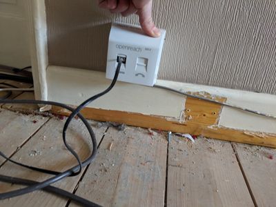

Recently moved house and master socket is in the way of a sideboard we wish to have in hall. NTE5c with Mk4 VDSL plate so a little bulky.
Ideal solution is to shift the master socket a couple of inches to the left so its above the skirting aboard and next to the door frame, compared to at the moment installed on the skirting board nearer middle of the hall. Only problem is that the cable running from the junction box which is next to the front door is too short. The shift would be be less than half a metre.  (Around 2-3m between master and junction box).
Had a look inside the junction box and all it seems to be is jelly crimps - presumably a master socket relocation done by previous owners.
I'd like to try and do the job myself but need advice on what type of cable I would need to run from junction box to the socket (the existing cable seems heavily deteriorated and exposed in a couple or areas along the length). And how to re-wire the new cable to the outside line within the junction box.

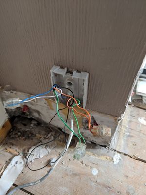

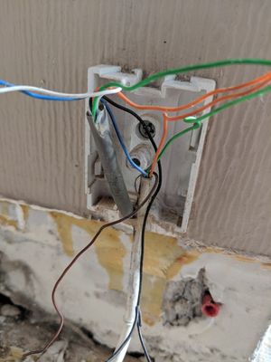

Re: Master Socket shift
Here is junction box.
I did snip off the brown and green wires as they weren't attached to anything within the master socket - just the orange and the blue.
NE

Internet now dropping intermittently.
Will have another go at redoing the crimps and A/B terminals.
Any other advice?
