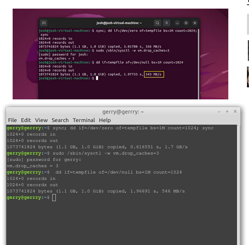

@Baldrick1  OK.. from the link, I used the Terminal instructions and here is a copy of the page.. Top part is the one that the author of the page did on his machine....
bottom is my terminal result..... which shows that my machine ssd is running (546)  slightly faster than his  (543)!..

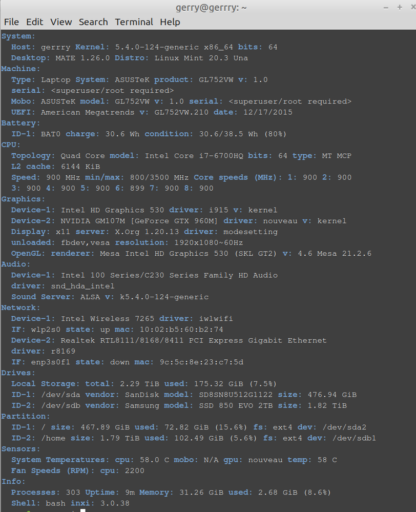

@Dan_the_Van
Here is the full page of inxi -F

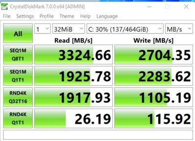

@Baldrick1   Here is the result of Crystal Mark.
 (runs in WINE no problem)
Not sure about what the settings were at the top, so left them as is from the install.

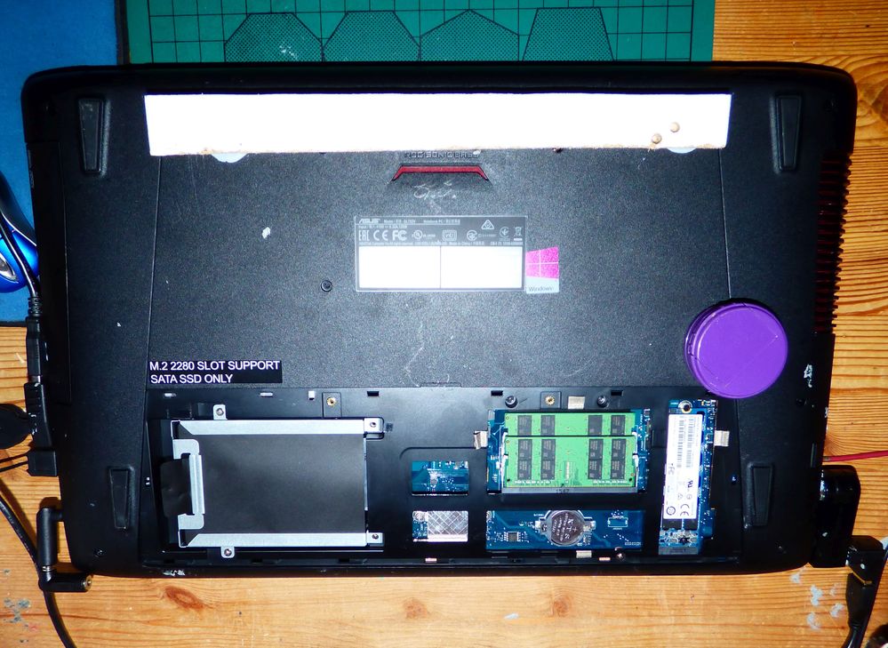

@Dan_the_Van  Fortunately, I still have tbe underpanel removed, and the photo clearly shows the location of the SSD  ( bear in mind this is upside down - so location on the keyboard side will be mirror image)
Underside of laptop;
The round purple lid is where the hot spot area is roughly,  ( its a plastic cap off something ! ) .
Keyboard side.
_ SSD is  on the right, where the white square tissue is... and the hot spot area is about where the three little labels are on the left side
As a point of interest, the SSD is cold.. no peceived heat in it at all...

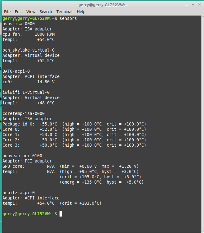

This. I hoped would improve the airflow, on the  "input" side from the front edge of the laptop.  After about 90 minutes. the  central  keyboard area still seems to be quite warm.. although the main "Hot Spot" area, seems to be slightly cooler,        The main heat area seems to have moved, to a more central location on the keyboard, from the top left of the touchpad area and to the area covered by the keys cvdfgert.
Checking the "sensors" printout, there does not seem to be any significant differences between this morning and yesterds.

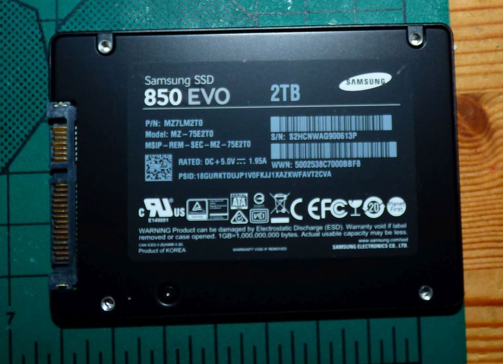

With reference to the SSD`s.   The main large black Drive, is, in fact the 2TB SSD. and this is located at the right hand side of the keyboard area, and is totally cold.
The 500GB SSD is the long thin component, on the left hand side of the keyboard, where the initial, and contnuing,  hot spot problem area is.
