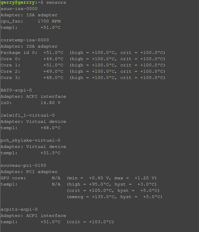

Here is a screenshot of  Terminal screen  - "sensors"   ( Linux Mint 20.3 )
I don`t know what all the information is telling me... so am guessing that the running temperature(s) around about 50c are OK.   but would like someone with a more knowledge to interpret and advise if anything needs to be done .

@Dan_the_Van Thanks for the interest.... No other research. other than monitoring the "sensors" on the Terminal window... seems to fluctuate around the 54c mark.

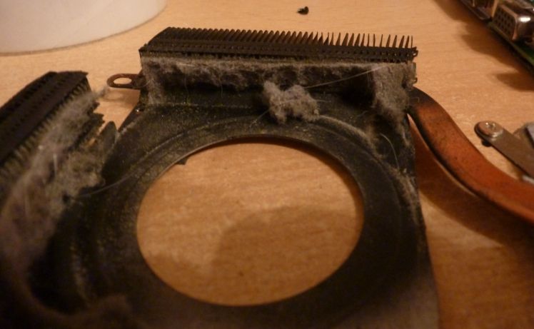

Bit did you take the fan assembly apart and clean the actual cooling fins? - here's one i did years ago that was badly overheating..
screenshot-1434
The fan itself looked fine, the heatsink looked fine but when i found that the fan was still going nuts on reassembly it was clear something wasn't right. Took it apart again but opened up the fan assembly (hidden screws) and found fluff as thick as a new carpet in there. Removed that, no more cooling problems.

The main question of the post was that I was concerned as to whether the given temps in the screen shot were "acceptable" running temps, or are they showing up some other fault if they are too high .

As far as the devices are concerned 50°C is fine. What's intersting is that this heat is building up inside the case. As the fan is working I was looking for some other device that could be producing heat that isn't being monitored. The PSU regulator being my immediate thought. Apart from the CPU cores I don't know what the other temoerature figures are monitnitoring. The other component that comes to mind that can get hot is the graphics chip.

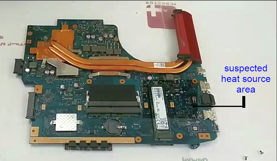

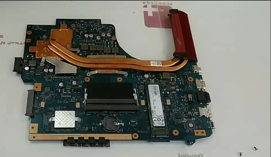

Been looking at the video I used to remove the cooling and replace the heat paste and taken some stills from it.
Main board as seen with keyboard, & cooling fan , removed.
The "darkened square" in the top right part is where the heat seems to be generated...( see other pics  )
Underside of main board with cooling
Underside with cooling removed
in the last pic, I have "lightened" the area that seems to be where the main heat area is on the keyboard.  So, it looks as though the heat is not caused by the cooling pipes and processor blocks on it.

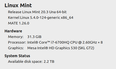

Does the laptop have a 2.5 inch SSD or HDD as that can be a source of heat, from the photo it looks like M.2 SSD card to me

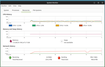

How much memory does your laptop have? System monitor will give a clue as if the pc is running hot for a reason
If the CPU usage is high then it will hotter, I expect you already know that. This result in the fan running and getting faster if it get hot inside the case.

shutter
Posts: 22,424
Thanks: 3,879
Fixes: 67
Registered: ‎06-11-2007
Re: Hot Spot
@Dan_the_Van
OK... thought I would remove the battery.... but it is not an easy job, and is almost a full destruct method.. have to undo loads of screws around the base..  and then remove the keyboard (carefully) to access the battery.  ( numpty design ! ) .
so.. next thing .. just pull the power plug out... and see how that goes.
Yes it does have a 2TB ssd installed.
EDIT EDIT EDIT EDIT EDIT  ***************************8 SYSTEM PROCESSES RUNNING shows only my morse program  and the system monitor actually running... cwcom using between 8% and 16%  System Monitor at 16%  oh,... and Firefox-bin at 8% to 64% depending on what is happening to this page. ( it changes every couple of seconds ! ! ! )
System resources pics

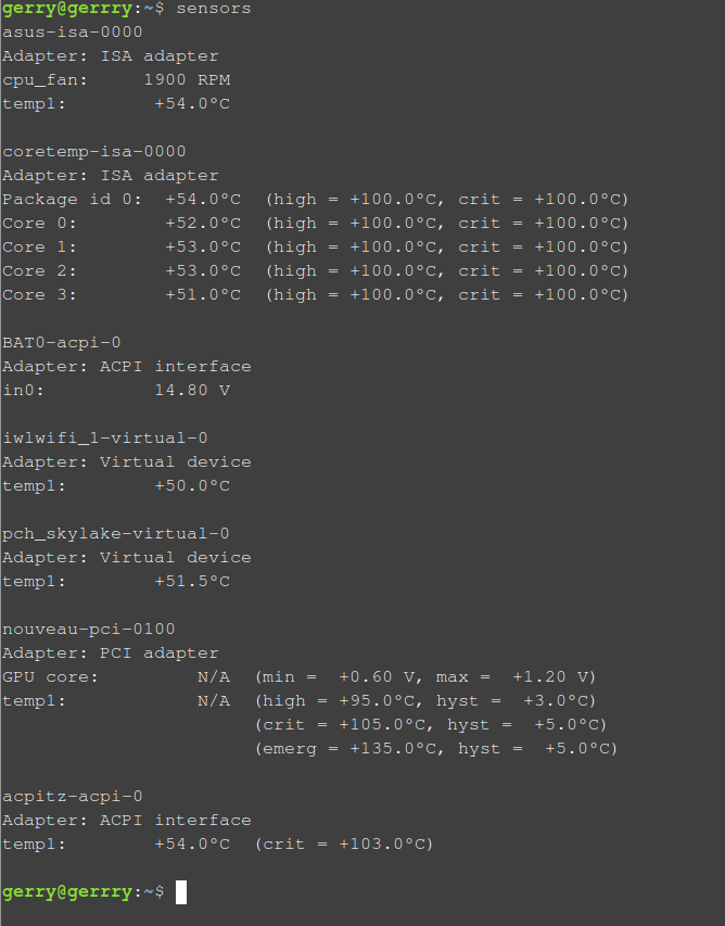

sensors report - after 20 mins with no mains power running.
Which does not look much ( if any ) different from the first posting.
Keyboard area still feels uncomfortable, though may be more concentrated around the are of the Z key spreading slightly west and more towards the south east to the left side of the touch pad area.  ( this is probably "conductive" heat )
Suspected heat source area
Note the darkened area is only a "guesstimated" area, could be more upward  and more leftward, as this is showing the underside ( therefore mirror image) of where the heat source "could" be coming from.
