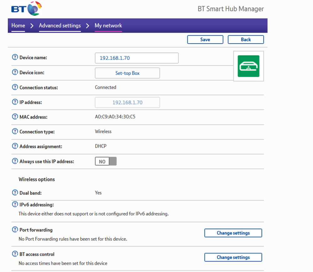

@Ronnie8M
If you log into your router and double click the Hive entry on the My Network page what results do you get? Below is a typical entry:
Is it reporting the correct connection type and Address Assignment? Is it also showing that no Port Forwarding rules or Access times have been set?

Hi - yes looks like that and shows a wired connection and DHCP for assignment address. Also shows no port forwarding rules or access times have been set up. One thing I forgot to mention and maybe should have is that I have a tp-link range extender fitted. Had to get this after switching to Plusnet as Smart TV connection kept dropping out. This is showing as 5 GHz connection - could the HIve Hub be trying to connect to this instead of the router? Thanks
