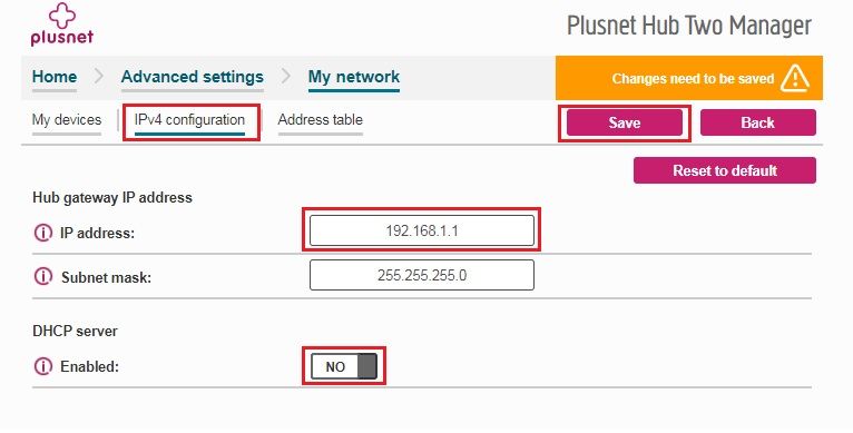

Sounds like you have a Hub Two. You can configure it as an access point and the Wi-Fi in the garage will be akin to what you get with the Smarthub 2.
To do this, you need to power up the Hub Two, log into the Hub Manager and make a few changes.
  1. Firstly, connect a device to the Hub Two and browse to http://192.168.1.254 (hub needs to be powered up, but not connected to the Internet)
  2. Navigate to Advanced Settings > My Network and enter the hub's admin password
  3. Click IPv4 settings and change the IP address assigned to the hub. This needs to be something that is not being used by any other device on your network. If you haven't fiddled with the Smarthub 2 config, then you should be safe to use something below the default DHCP range e.g. 192.168.1.1
  4. Disable DHCP
  5. Save the changes
  6. run an ethernet cable between one of the Smarthub 2's LAN ports and one of the LAN ports on the Plusnet Hub (do not use the fourth port, use ports 1-3)
  7. For good measure, power off both hubs; then power up the Smarthub 2, wait for it to connect to the Internet, and then power up the Plusnet hub.
Some things to be mindful of...
  • Because the Hub Two is not connected directly to the Internet, the LED on the front of the unit will likely flash orange. Despite this, devices conected to either its Wi-Fi, or ethernet ports, should still be able to access the Internet. Unfortunately, you cannot disable the LEDs on the Hub Two when it's in this state as it ignores your LED preferences when it thinks there is an error condition.
  • Without any further conifg, you will see two separate Wi-Fi networks with different names/passwords. If you'd rather keep everything the same, then you can change the Wi-Fi name/password on the Hub Two to match what you're using on the Smarthub 2.
  • If you configure both Wi-Fi networks with the same name, then it is down to the connecting device to decide which it uses. You may find that when you move closer to the garage, a device 'clings on' to the Smarthub 2 network, even though the signal is stronger on the Plusnet hub. If this presents a problem then it's probably best to keep seperate network names so you can force/dictate which hub each device connects to.
  • When a wireless device moves from one hub to the other, you may notice a very brief interruption in connectivity.
  • If you look at the network map in the Smarthub 2 Manager, devices that are connected wirelessly to the Hub Two will likely show as wired. This isn't anything to worry about but can cause confusion if you're not expecting it.
  • If you need to access the Plusnet Hub Manager for any reason, then you need to browse to the new IP you assigned it e.g. http://192.168.1.1 and not http://192.168.1.254 (the latter will take you to the Smarthub 2 Manager)
