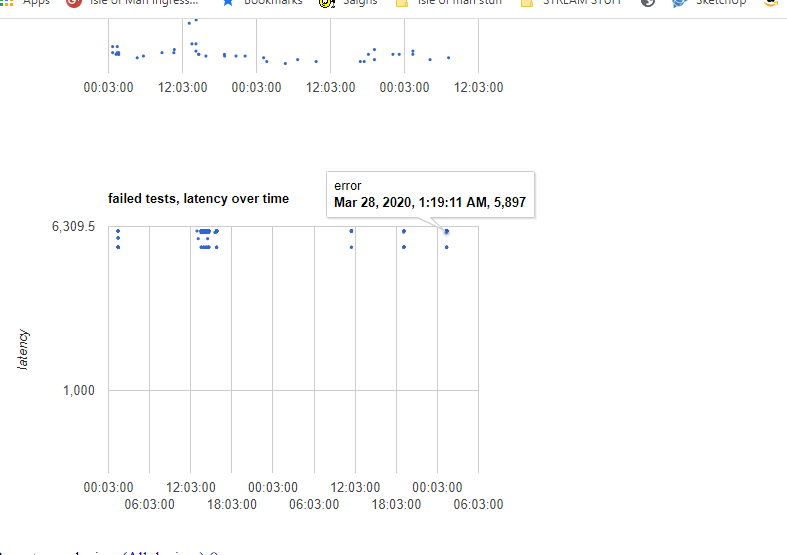

This is my point. the standard operating procedures do not cover issue faced by me. and probably by others. so they either need to be changed, or new ones put in place to cover them. hiding behind an SOP is the reason im unhappy with the service.
Whenever an engineer visit is arranged there is the warning that the user might be charged if no fault is found in BT’s infrastructure.
Even when an engineer does attend and the find and fix one fault they do not going looking for others. Though as I hint above, a cable defect might not exhibit a fault all if the time.
This is what bugs me the most. i have applied everything plusnet asked me to do. yet was still having issues. clear issues that were recorded on their system. image15851449643071.png
how can they say there is no fault, when this is happening? how is this a fault that is not exibited?
- the Openreach engineer said to me that the property should have been checked on connection of the service. and that checks should have been done every time an engineer went to look at the issue.
Yet i STILL have a connection dropping issue.

SOP for line faults is set by BT Openreach not Plusnet.
You've responded to most of the points I made, except the most important one - have you done (did you do) a QLT?
Broadband is not going to work well if the "phone" line is not working properly.
Please perform a quiet line test - dial 17070 select option 2 using a corded phone plugged into the test socket behind the face plate of the master socket. It should be silent. A noisy phone line (or no dial tone) will have a marked adverse impact on the performance of broadband.
If the line is noisy or there is no dial tone, then a PHONE LINE fault needs to be raised with your phone provider. If this is PlusNet, you can report a fault on line using the button below.  From the Q&A list, choose the one which matches the problem, 'open' the 'section' and click the trouble-shooter link.  NB: If you receive a failure message (rather than a log-in prompt) then log-in to the user portal in a different browser tab and attempt to use the trouble-shooter again.
Given the faults you mentioned, one would expect a lot of audible noise on the phone line.  Checking for line noise is the first line of SOP, however many users do not have telephone handsets claiming they have no use of the phone and refuse to obtain one to help diagnose the problems.  Not having a handset connected also results in an inability to see if any of the faults experienced are connected to a call being placed on the line.
In certain conditions what seems like just a piece of wire can act like a complex electrical circuit of capacitors and resistors to the high frequency signals used for xDSL.  Sometimes (not often) the characteristics of a circuit can look different if tested from the exchange to that tested from the premises.  Similarly the effect of ring (or test) currents / voltage on a line can alter defects cause by corrosion.
I have experienced a line which tested fine from the premises but the automated exit test (from the exchange test head) still reported a fault.  The BT Engineer claimed his tests were fine so the exchange test head must be faulty.  Some two or three repeated visits later, a different engineer went and tested the circuit back from the exchange and found that there was indeed a fault on the line … quite close to the exchange.  IIRC that ADSL line was only delivering 15Mbps just outside the exchange, where it should have been close to 24Mbps.
Network diagnosis is more art than science, for invariably for intermittent issues, they are not manifest when testing is performed,  Totally broken connections are far easier to fault locate than ones which fail some of the time.  Such unfortunately is a fact of life!

Thank you for the radius log plot - very helpful.
@JJmcneil
I note a very regular disconnection between 00:45 and 02:00 on most days, except last Sunday when the clocks changed.  Are you aware of any electrical system in the vicinity which has an on / off event around that time?  ERM from switching events can give rise to connection failures of the characteristic shown on your connection plot.
Degraded lines such as the one you have described are more susceptible to such events.

thanks for the replies folks. i will check as soon as a phone arrives from ebay (dont even own a home phone anymore)
thanks for pointing that out. i hadnt noticed. i have a ton of radio recieving gear in a cuboard that i could maybe have a look with (no transmit and also not powered up so its not that) thanks for that point.
It does seem better. but has still dropped. im leaving it for a while to see if there is a proper improvement, as this is the faults M.O. - i shall report back if i find anything.
