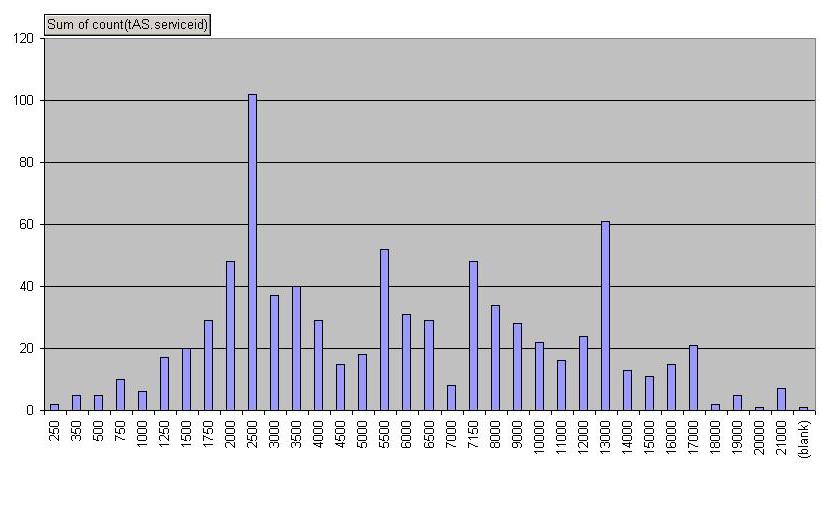

Starting off with 21CN, the mean speed comes out at 6533Kbps. Below is the distribution of the speeds across all of our triallists.21cn Bras speeds July 09

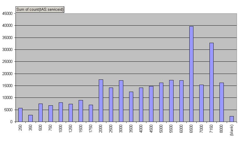

For 20CN, the mean speed is 4520Kbps, so taken on average 21CN is certainly offering faster speeds, although of course a lot of the big gainers are those living very close to the exchange.
Below is the distribution of speeds for our 20CN customers.
20cn Bras speeds July 2009

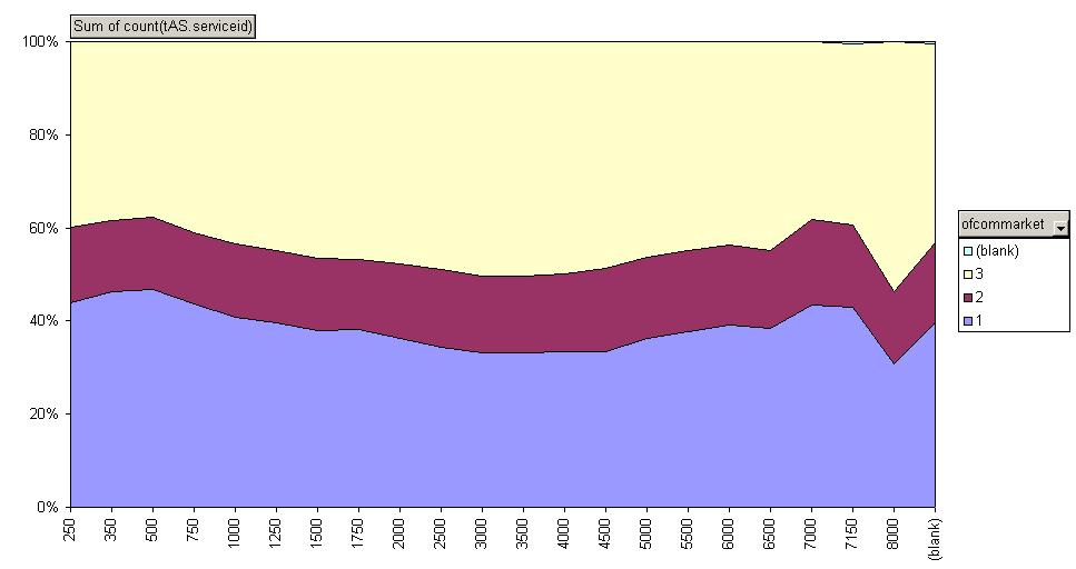

The UK broadband market has been split up by Ofcom into three distinct market areas (four if you include Hull). Each exchange in the UK is determined to be within one of three markets depending on how many wholesale suppliers operate there. Four or more suppliers make it a market 3 exchange, two or three supplier make it a market 2, and only one make it a market 1 exchange. Generally the market 3 exchanges are located in the more urban areas where there are bigger exchanges with more customers while the market 1 exchanges tend more to be the more rural exchanges that serve a small number of customers. There are of course exceptions, but it's interesting to look at the split of speeds by market to see if there are any difference. This graph shows the speed distributed by market.
Bras speed by market
As you can see there are a couple of patterns, the market 1 lines have a noticably higher proportion of lines with lower speeds, probably because of rural nature where the line lengths to properties outside the towns and villages are very long. Market 3 has a lot more lines in the middling speed areas, what you'd probably expect from urban areas where line lengths aren't as long as the rural runs. Market 1 does catch up again with some of the faster lines, again likely because of a lot of people in small towns and villages living very close to the exchange.
