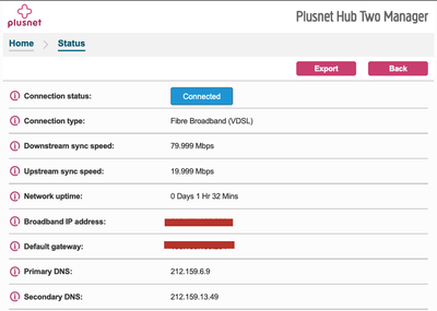

Long long time ago I switched my Hub 2 router to use Google DNS.  This morning I got one of those random glitches in the matrix whereby the router reports it's connected to the internet, but nothing can get online. That's incidental to this query anyway, but  when I logged into the router, I saw that the DNS servers had apparently reverted to the Plusnet ones:
I thought maybe router settings had automagically been reset as my fibre BB package recently expired and I had to renew it again. So thought maybe that might have reset some settings on the router.

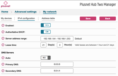

So I went nto the Advanced section to change the DNS server settings back to Google DNS again and found that the router is still supposed to be using those:
So why is the router [apparently] ignoring my custom settings and still using the default Plusnet DNS?

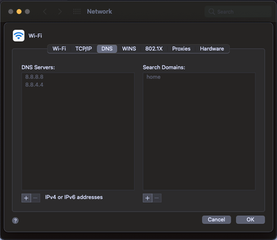

Hmmm... interesting. I've just checked on my laptop, which is set to use DNS provided by the router and it is correctly showing Google DNS being used:
So, maybe the router is using Google DNS after all and it's just another example of the clunky interface showing wrong or confusing info?
It isnt!. The broadband status page is showing the DNS servers obtained from the PPPoE connection, which will be PLusnets.
The custom DNS settings are in the LAN setup and are the DNS servers that the router will issue to DHCP clients ( instead of its 192.168.1.254 default) and as you see they are correct.
