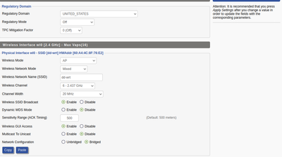

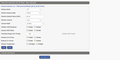

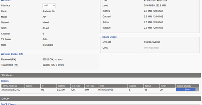

Hello, I have attached 4 screenshotsScreenshot from 2022-08-19 09-29-00.pngScreenshot from 2022-08-19 09-30-02.pngScreenshot from 2022-08-19 09-30-56.pngScreenshot from 2022-08-19 09-30-56.png

Unfortunately all those screenshots refer to wireless settings and are of no use in resolving the problem.
You need to post the WAN settings and the LAN settings so we can see where the problem may be
