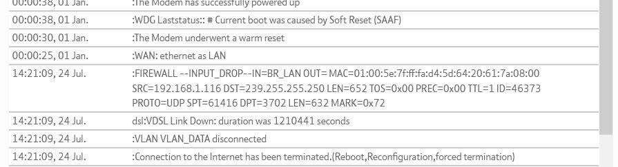

@dvorak wrote:
Mine had been up for 50 days (until I tripped the RCD, oops) so the 14 days doesn't seem to be a thing anymore
Strange, this is mine from 3 days ago. The fact that it was up for 14 days, 14 minutes and 1 second might be coincidence of course.
I believe that we are both using a model 088315 with the latest firmware, SG4B1B0092C4?
Posts: 30,503
Thanks: 6,965
Fixes: 1,495
Yeah, same model and firmware.
Mine has currently been up for 15 Days, 16 Hours 20 Minutes - which is when the firmware updated.
