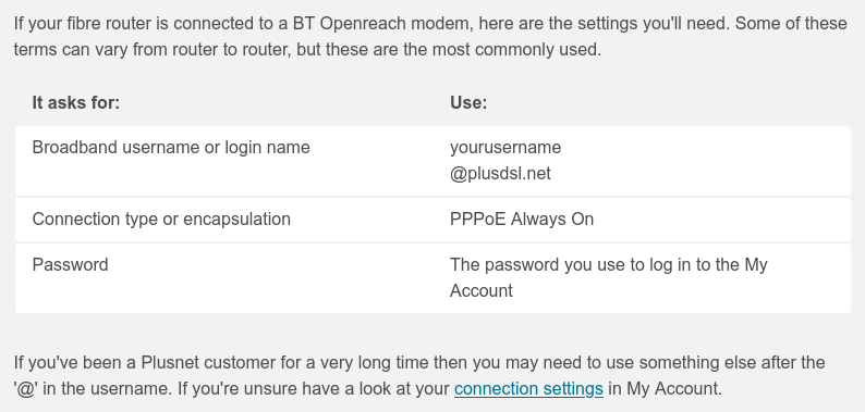

From Connection setting FAQs -
Confirm the format of YOUR 'username' or 'login name' by looking at YOUR connection settings

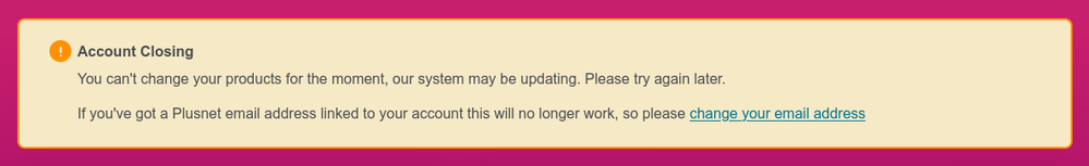

It might be worth logging in to the "Member Centre" then visiting this - https://www.plus.net/member-centre/home
On MY closed Plusnet account it shows this banner -
I can't remember whether that appeared when my broadband service ended, or after my final bills were settled.
