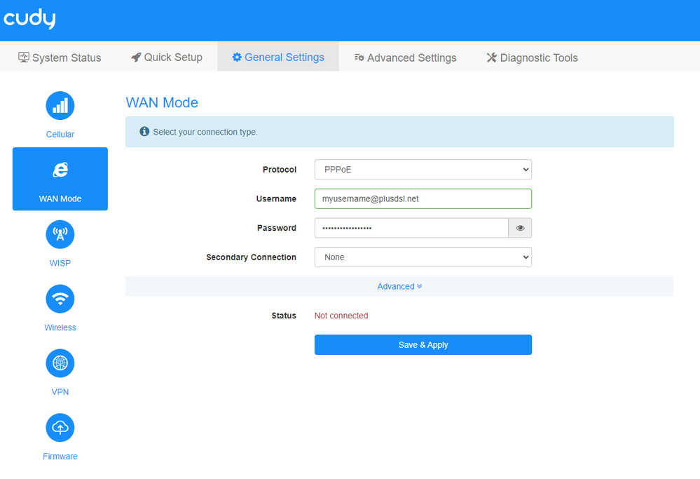

Good morning,
I am trying to get a third-party router working with my Plusnet FTTC connection. I know this router works with FTTC PPPoE connections as I've had it working in the past.
I've double-checked my credentials and I am sure they are correct, but I keep getting this in my router's log:

@christ  It is showing chap authentication failure so the first thing to try is to login to your Broadband account (Member centre) with your username ( without the @plusdsl.net bit) with the password you are using on the router to check that your credentials are correct.

Oh my gosh, I feel so stupid. I'd included a space at the beginning of my password.
I spent most of yesterday evening with cables strung across my office, trying different routers and testing ethernet cables, and it was the &£^*^$*& password, which I thought Ihad been careful to copy/type correctly.
I will now try again with my MikroTik router later and see if I can't get this thing working properly.
