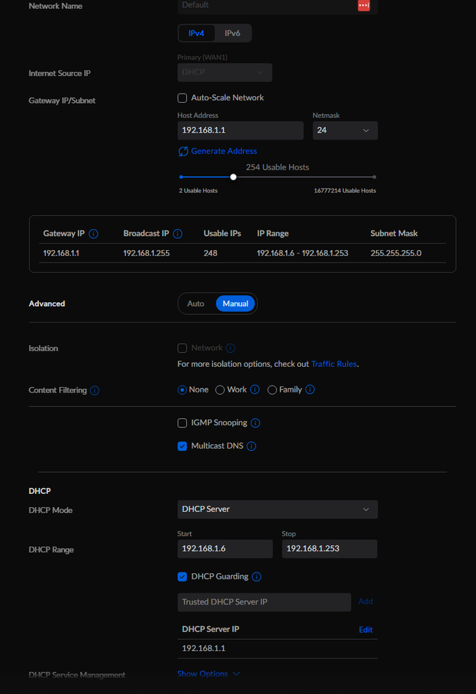

I played around with the DHCP server settings last night and set the range to be 192.168.1.6 to 192.168.1.253 just as a sanity check though correct me if I'm wrong but the plusnet hub two gateway shouldn't matter whilst its in bridge mode? The device running the server is using a fixed IP of 192.168.1.100 which the server is set to run from, and the UDR gateway IP is 192.168.1.1. I'll attach the picture of the DHCP server settings as well.

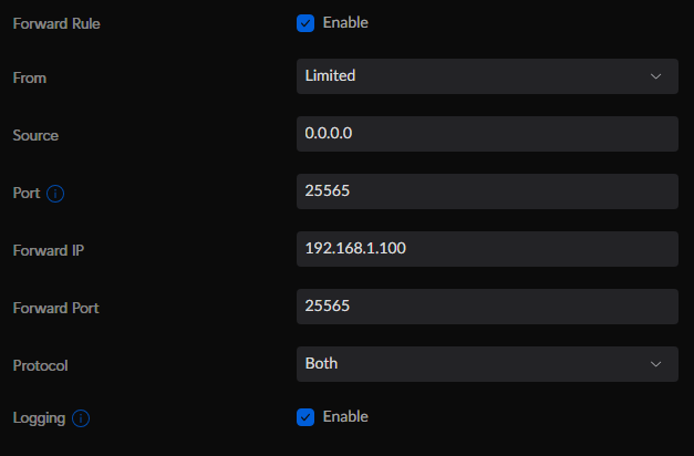

Bit of a long shot, I'm wondering if using 'Limited' rather than 'Any' for the incoming IP Address (From)
But, rather than a specific network range use 0.0.0.0 with mask of 0.0.0.0
0.0.0.0 would be a connection from any network address.
bradleyp
Posts: 22
Registered: ‎17-03-2024
Re: Unable to Port Forward using a Ubiquiti Dream Router
I've attempted that, let me know if I've done it wrong but it still doesn't seem to be working for me. Though thanks for your reply - been bashing my head against the wall with this issue for multiple evenings now.
