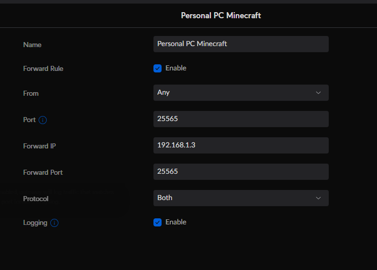

Looking at this link https://www.wundertech.net/how-to-port-forward-on-unifi-devices/ I see it is possible to set Inbound connections (From) to a Limited network range or Any. Did you set the rule to be Any?
A matter of interest what are you trying to forward, have you thought of testing the port forwarding rule will work on the Hub two?

Right now I'm testing it with a Minecraft server (don't judge lol, just done it a million times so its the easiest way for me), my current rule is indeed set to Any, I've not tested it with my Hub Two but I'm about to head out so I'll test it with that when I'm back home. Thank you and MisterW for your replies so far!

If you are happy can you post a picture of the Ubiquiti and Hub Two port forward rule you have created?

Yes it is indeed pink, sorry I've already put it back in bridge mode so I cant right now get a photo of the old port forwarding rule. Though it was very similar to this except on my UDR setup I've set that IP as a fixed IP for my PC.

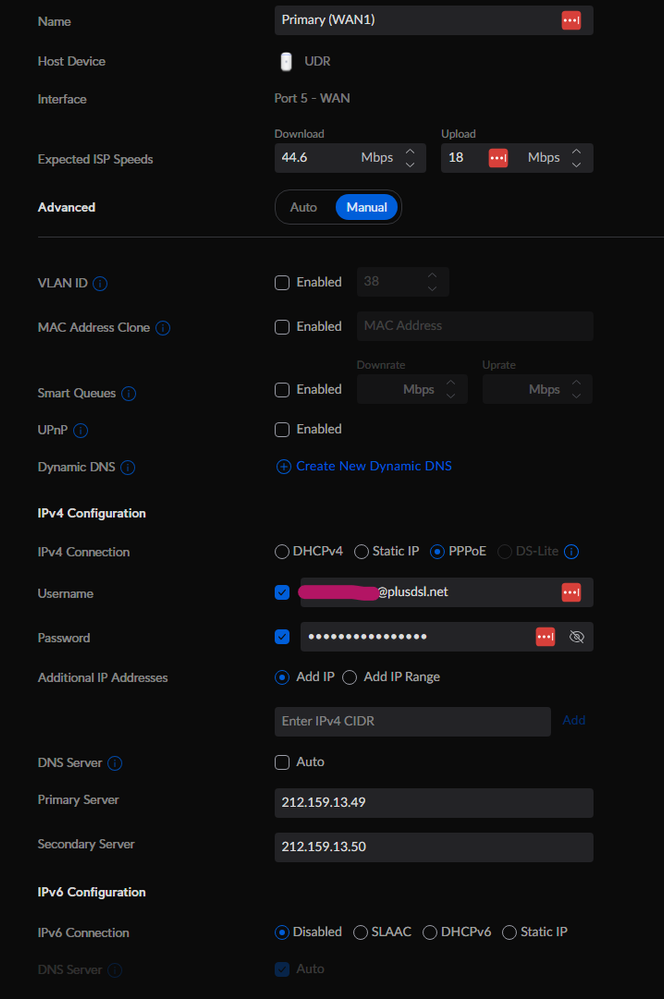

Got a sneaking feeling I've done something wrong with my initial setup, so just posting this if anything jumps out to anyone.
