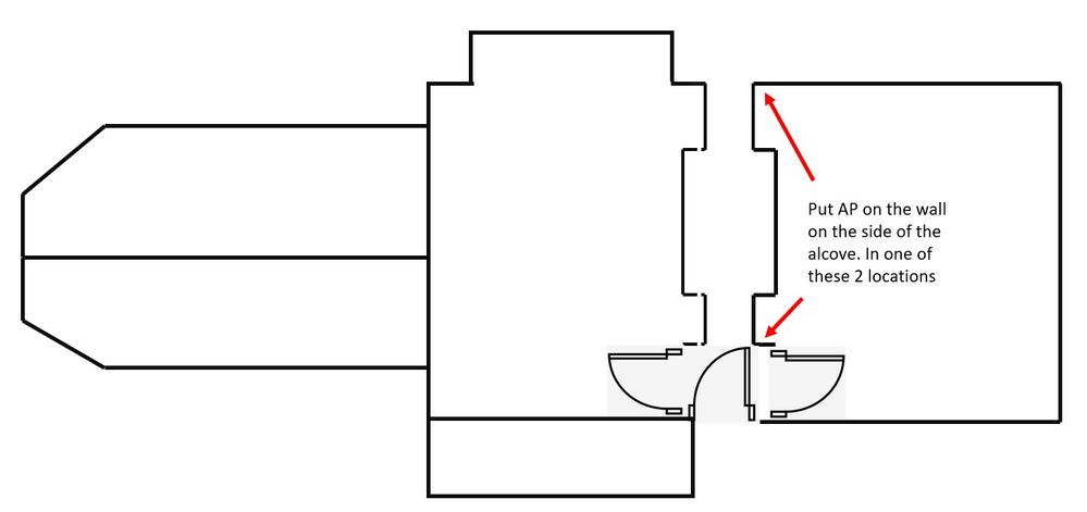

I am planning on putting 1 ap in one of the indicated locations and am hoping it will cover the whole flat which is 90m2 as the ubiquiti access points say they cover 140m2
