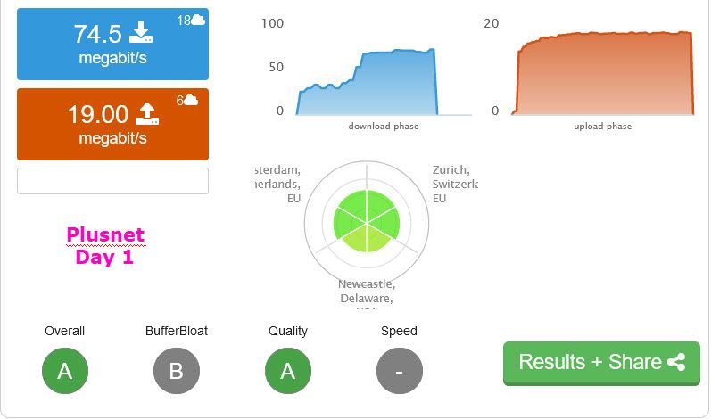

Here's my day 1 Plusnet line stats, obviously downsteam is going to be interleaved over the next 14 days while my line settles in with DLM making the necessary adjustments, although I'm pretty stoked with my line compaired to BT at present.
Re: New customer with a third party Draytek Vigor 130 modem and Asus AC5300 router
That's looking good.
I'm surprised that the far end error counts "FE CRC Count" and "FE ES Count" haven't been zeroed, as I would have expected that your line should have been reset for a clean start after migration, maybe that has been scheduled for the early hours of tomorrow morning.
With those line stats, your Vigor 130 should be able to reduce the "Cur SNR Margin" to 3dB, and get your downstream "DS Actual Rate" closer to 79999000  if DLM behaves favourably in the next few days.

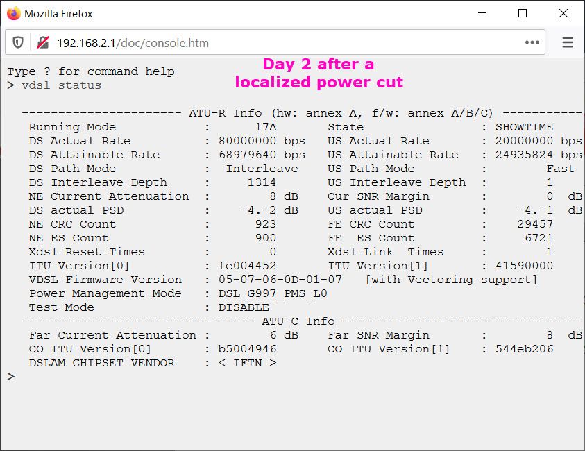

I have by accident achieved what many people dream of with their 80/20 FTTC connection with a DS speed of 80000000 and a US speed of 20000000 and an SNR of 0, although as can be seen in the attachment my NE CRC and NE ES counts have recorded quite a few since 8pm yesterday evening.
The reason behind this significant change is that around 8pm last night the whole area around my town experienced a power cut for approximately 5 mins, you'll also note that my attainable speed has dropped significantly.
I am unsure if this part of the line testing phase where settings are altered to attain the best achievable speeds, although for now my line is running at maximum with a few NE CRC and NE ES counts.
Hopefully things will settle down over the next 14 days and the weather calms down to prevent another power cut in sunny old Wales. 😂

@mszune  Its one of the reasons I gave up trying to always get the best of a setup. As you've found, DLM will always have its way. If it decides your line should go slower or faster, it will do so, no matter what settings you tinker with. With my ISP (no longer PN) I can easily see how often DLM alters things when it decides its going to. Since November 2020, my line has resynced 25 times - usually a meg or 2, up and down. I was 78256 in November, I'm 78506 now, which was set in January. Miniscule gain really in the grand scheme of things.
Unless I think my line has a problem i.e. going slow, I no longer bother doing speedtests, checking the stats etc - You can easily end up going around in circles. The time spent doing that is better devoted elsewhere. Like doing what you really wanted to be doing in the first place - using the net! 😀
As for the 10-14 days training, biggest humbug around. DLM is always active. Your line might (probably will) stabilise at some point but DLM is always there - lurking, ready to take you on a trip. 😁 Best thing I did was get a UPS - £30. Its done wonders for the speed syncs. Modem never drops.

@mszune  That is a common occurrence after a power cut. Your modem syncs up before others at a higher than normal speed then other lines come up and reduce your SNRM due to crosstalk. Your SNRM is now at zero so your errors are going very high. You are not likely to continue at that speed for long. DLM will cause a resync and your speed will drop.
My line runs at 80/20 after a power cut at about 1.7dB SNRM with next to no errors, currently been up for 20days.

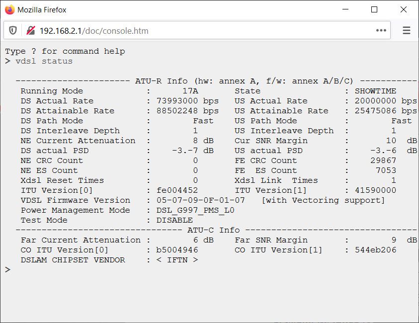

I have a question, since my switch to Plusnet on the same day as a localised power cut on Friday my line has now been reduced by DLM as attached below.
I noticed that the XDSL times is now set at 2, does this indicate that DLM has done something or has someone in my house switched off the router/modem at some point?
The reason I ask is that I have kids in my house that are on the internet until the early hours and I want to rule out someone resetting the router/modem when it will impact our line?

@mszune  This is exactly what I said would happen in my previous post (message #24)  You had a very low SNRM so DLM has caused a resync and the line is now running at the normal 6dB SNRM. That explains the XDSL link times value of 2.
What is not good is that your downstream rate is now less than you had on your first day on Plusnet and looks like it may have been banded, that is capped at 74Mbps, because the speed is almost exactly that value rather than some random number. You may find that the sync speed does not go any higher. You could ask Plusnet to check your line to see if it is banded and they could request a DLM reset but as you are already getting a good speed they will probably say you are within the expected range and do nothing about it.🙄

@RealAleMadrid thanks for update, I thought the little sh*~s had been switching off the router again 😂
Yeah it looks like the DS is banded and also lower than my first day speed, to be fair my line hasn't been reset since I joined from which I thought that my US would have been reset from day 1.
I will let the line settle in over the next 10 days and see what happens, Thanks for the help and guidance much appreciated.

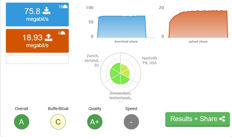

@Anonymous @RealAleMadrid so after two weeks my line settled down to the below profile from which I guess as my line was never reset on day one it has reverted back to its old banding.
I can I suppose ask for the line to be reset, although I thought it was a worthwhile mention that having read multiple posts relating to the Vigor 130's 3.8.4.1 BT firmware and that is not entirely compatible with an ECI cabinet, I have for the last 5 days ran the 3.8.4.1 alternative modem code 579F17 firmware recommended for ECI cabinets that has seen a 3mb increase to the DS and US attainable speed as below.
Whether or not DLM will adjust my line as it is now more stable only time will tell.
