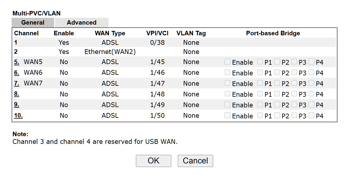

I have several screenshots, posted below. The ACT LED is flashing slowly'
Thanks again.

Screenshot 1 shows no DSL connection, have you got the DSL port connected to the phone line ?
This link https://www.draytek.co.uk/support/guides/vigor-2860-vdsl-setup shows the typical settings for an FTTC (Openreach) connection.
The username in your case will be <accountname>@plusdsl.net and the password the one you use to login to the member centre https://www.plus.net/member-centre/login
If checking those settings doesnt fix it, then post screenshots of WAN1 detailed settings as in the link above

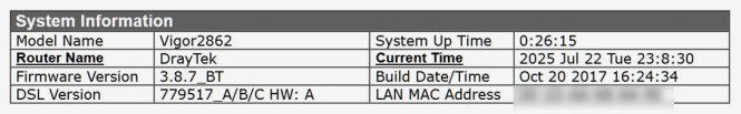

@Jaxon
You are wasting your time trying to configure your Vigor 2862 until you update the firmware !
Your screenshot shows that you are currently running firmware version 3.8.7_BT
That is hopelessly out of date, and has been superseded by THIRTY official updates, up to the current release 3.9.9.11_BT
As you have it now, if you did connect to the internet you would be vulnerable to the widespread attack on unpatched DrayTek routers as reported by the ISPreview article "Broadband ISPs Report UK Problems with Vulnerable DrayTek Router"
To update your Vigor 2862 firmware -
  1. Download the latest official firmware (zip file) from here - https://www.draytek.co.uk/support/downloads/vigor-2862?task=download.send&id=4036:v2862-39911-bt&cat...
  2. On your PC, extract the update files from the downloaded zip file.
  3. Using the Vigor 2862 web interface, navigate to [System Maintenance] > [Firmware Upgrade]
  4. Upload the firmware update file "v2862_39911BT_779517.rst", and let the update run until completion.
  5. Once the firmware has updated and subsequently rebooted, take another screenshot showing the updated firmware version, and post that image here.
Once you have the latest firmware, there are a few configuration settings that need checking before you go online.

Be aware that the update process described above deliberately resets the Vigor 2862's configuration, as your previous unsuccessful configuration attempts might have messed up something, and that updating 30 firmware release versions in one go is asking a lot for the new firmware to import or convert the settings from an eight year old configuration format without issues.
Therefore after the update and reboot, the LAN address and login will have gone back to the defaults -
  • LAN address = 192.168.1.1
  • Username = "admin"
  • Password = "admin"
Jaxon

I updated the firmware, ran the Setup Wizard and success, well kind of. Vigor was working but no internet. Opened a command prompt, ran ipconfig and noticed the that the default gateway was wrong. Ran ipconfig /renew and here I am.
Thanks to both of you who patiently helped, but I think I had a senior moment where I hadn't followed the very easy setup wizard.

I did the firmware update and selected the All file. It kept my password ETC, but as I above ran the Wizard ETC.
