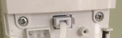

3. Plug your router into the master socket: The router is already plugged into the master socket. We have no extension sockets. See attached for photo of master socket.
4. If you need to use microfilters, make sure they're working: We do not have microfilters. Instead the master socket has a clip-on front panel which I think serves this purpose?

Thanks for the suggestion @jab1. I've plugged the DSL cable into the TEST socket using an old ADSL filter I have, as shown in photo attached. I can't see how this could be achieved *without* the filter - because the plug is an RJ11 and won't fit the TEST socket on its own.

Looking at the picture, I can see the 5C unit is screwed into a solid wall, and you say the front plate 'wobbles'. This is a common problem - if the wall is not t totally flat, and the unit is screwed down too tightly, the front plate does not fit correctly and internal connections get flakey.
Not an ideal situation, but I bet if you leave it like that for 48 hours or so there will be no further issues.
