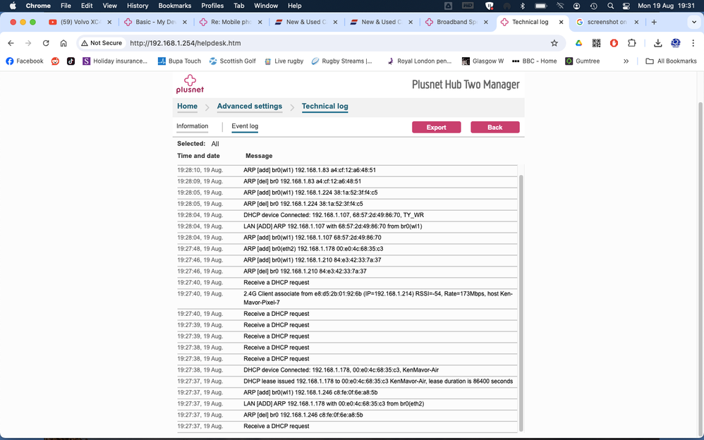

When trying to connect from my phone (Pixel 7) and my wife's Iphone.....
Obtaining IP address.......
Saved....
Saved...
Authentication problem

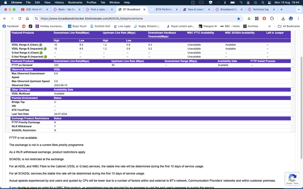

No corded phone available.
Quiet line test was quiet.  No noise on it at all.
Posts: 24,791
Thanks: 8,860
Fixes: 378
Re: Mobile phones not connecting to Hub2 wifi
Ken, thanks for those two bits of info. You are obviously on a long 'final mile' of copper - as you indicated earlier. The Quiet Line test is encouraging - now we just need the rest of the information.
