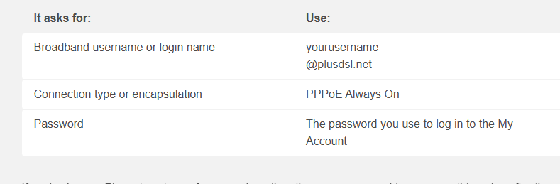

The first screenshot are the settings advised for a FTTC connection. The second screenshot are the settings advised for the FTTP type. I have just spoken to PN now and they advise that the ONT box will take care of the VLAN settings that are needed. They also acknowledged that the linked page is not correct, as well as the information sent to me. The agent will inform those responsible for the information being given out, as well as what is written within that linked page, needs to be changed to omit the VLAN part.
The current advice is to need to use those VLAN settings, as it was advised in 2022, in that linked post, to avoid authentication issues. But, from what I understand, that will cause them due to the ONT box.
The ONT box is acting the same as the Openreach modem did for the FTTC connection.

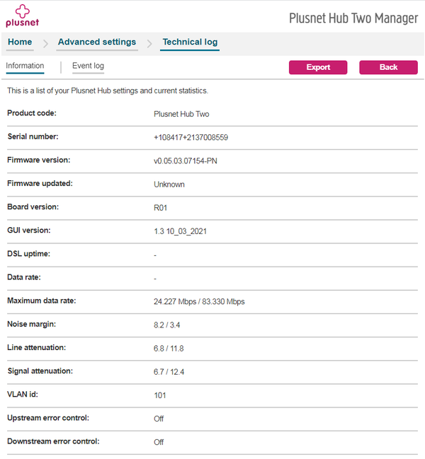

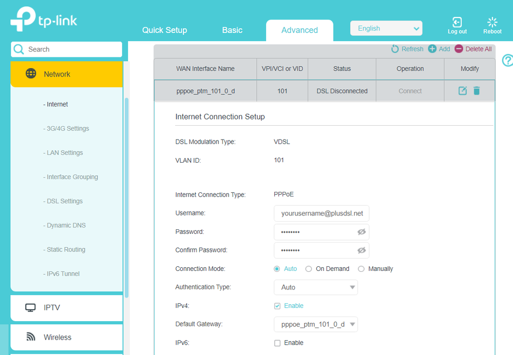

The problem with all of this is the help pages it only mentions a router where it should mention a combined modem/router, where a VLAN 101 may be needed to be set. As mentioned the Openreach Modem or ONT have VLAN 101 set
Here is an example of a TP-Link VR400 (modem/router) device I once used.
If I had NOT enabled VLAN 101 is would not have worked
With a Hub Two in "bridge mode" (modem only mode) like the Openreach modem and ONT the VLAN 101 is already set

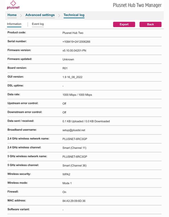

Hub Two used with Full Fibre
