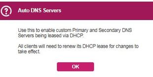

Posts: 4,997
Thanks: 3,305
Re: Hub2 Router Status shows PN DNS and not Cloudflare I've manually added
If you are looking for better DNS performance set the computer to use 1.1.1.1 & 1.0.0.1
Settings the Hub two DNS found in the IPv4 configuration should do the same, also less work.
From the Hub two
