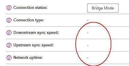

@bobpullen
hi, just wondering if there are any plans to add downstream/upstream sync speeds and 'uptime' in future firmware releases?

@jab1 The Hub Two is being used for the DSL connection.
You can see the Max data rate being reported, but actual data rate and Uptime info etc is omitted, while in BRIDGE mode.

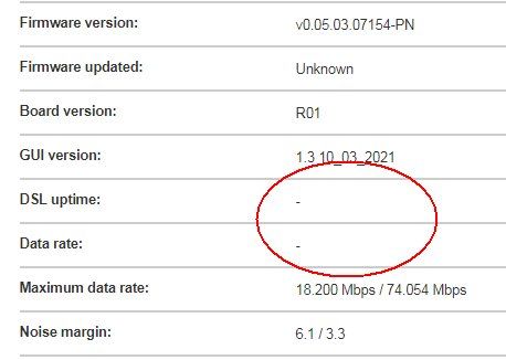

@bill888  - This has been discussed elsewhere (can't locate the thread at the moment) and yes, there is a request on the backlog to expose the information. On some of the pages, it can actually be found in the javascript, however for whatever reason, it isn't being presented in the GUI itself.
@greygit wrote:
The same info is missing from the Status page when Hub2 is not operating as a modem.
I don't understand what you're implying here?
When the hub  is operating as both router and modem, the information *is* presented.
When it is operrating as modem only i.e. bridge mode, it is not (looking to fix this).
If the router is operating solely as a router/access point, then I would not expect the information to be presented.

Not when you've manually 'disconnected'/dropped the ATM connection (i.e. at that stage the Hub2 would be operating in a bridge mode, but the previously displayed measurements evaporate until the connection is re-estanished).
Does that clear any confusion?

So to be clear: you can navigate to the Advanced Broadband Settings, click disconnect to drop the PPP connection, and the DSL stats are not visible despite the hub still being in sync. Correct?
greygit
Posts: 196
Thanks: 20
Registered: ‎13-11-2021
Re: Hub Two Bridge Mode - DSL status query
Correct.
