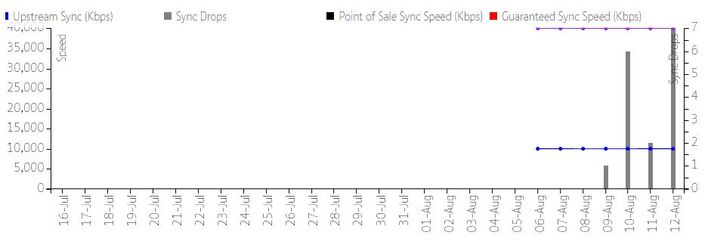

Sorry to hear you're still having problems. I did wonder at the time whether or not your issue was related given that you were experiencing problems with the 2.4GHz radio and were unable to resolve the issue by disabling 5GHz. Guessing you've swapped the device out now as not online? By the way, I'm not sure if this is you rebooting the router but your physical Internet connection seems to be dropping, but only during the week (grey bars below).

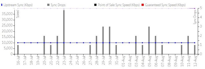

Again, sorry to hear things are still flaky. Looking at your network, the devices currently connected all seem to have a fairly strong Wi-Fi strength. Might be an idea to 'forget' then reconfigure the wireless connection on affected devices. You could also try renaming the 5GHz network to something else so you can tell your iPhones to explicitly connect to it, rather than deciding themselves which of the two radios to use. Remember though, the 5GHz channels do not reach as far due to the shorter wavelength.  There's a suggestion here that might be worth bearing in mind too.
You mention that the two issues aren't connected, however your Internet stability was looking pretty bad prior to the engineer visit! Definitely won't have been helping perceptions.

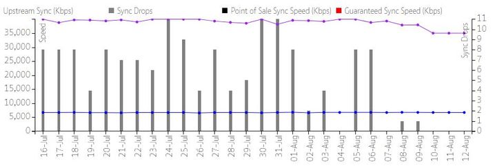

what do you mean 'having to reconnect via router admin'? One of your routers (serial ending '130') is not configured correctly in our hardware management platform. I've corrected that now but it could explain why you were having to repeatedly reconfigure the router.
Router configuration aside, your physical broadband line was not performing very well at all at the time you posted. Seems better now though.
