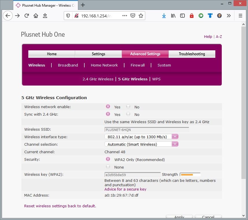

Disable or toggle the 5GHz radio
This is the simplest workaround, however it comes with a trade-off. 5GHz is faster than 2.4GHz and is less susceptible to noise/interference, but it doesn't work as well over longer distances. This means that whilst coverage is unlikely to be affected by disabling the 5GHz radio, you may see slower Wi-Fi speeds and be more susceptible to interference from neighbouring routers, Bluetooth devices etc. In the majority of cases though, this will probably be preferred to a situation where your devices lose connection entirely.
Here's how to disable the 5GHz radio...
  1. Access the router configuration pages by browsing to https://192.168.1.254
  2. Click 'Advanced Settings' in the horizontal navigation menu, enter the router admin password when prompted (found on the little removable card) and click 'OK'
  3. Click 'Wireless', then '5 GHz Wireless'

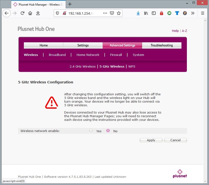

  4. Under 'Wireless network enable' select the 'No' radio button and apply the changes
  5. Accept the warning by clicking 'Apply' again

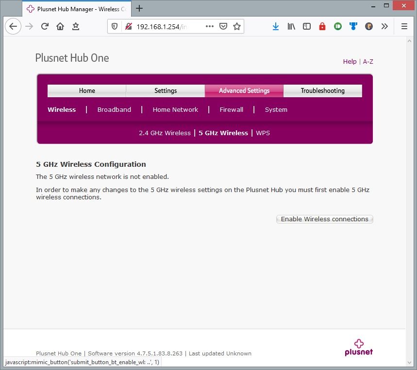

  6. A confirmation page is displayed advising that the change has been successful. You can revert this change at any point by following the same instructions and instead selecting the 'Yes' radio button
    Note: Some customers have reported that they are able to restore 5GHz connectivity by switching the 5GHz radio off, saving the changes, and then immediately switching it back on. If you are looking for a way to restore 5GHz connectivity without rebooting your router, then you might want to consider this
    Note: A red Wi-Fi LED will light up on the front of the router if either, or both of the Wi-Fi radios are disabled. This is normal.
