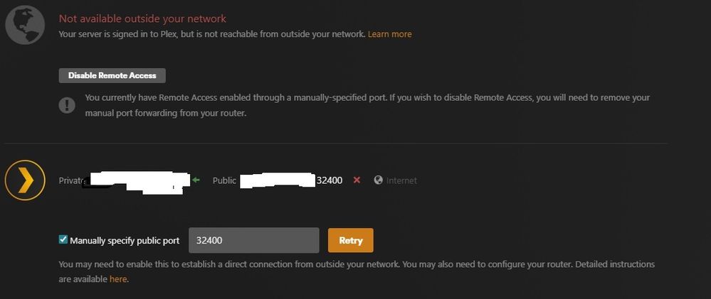

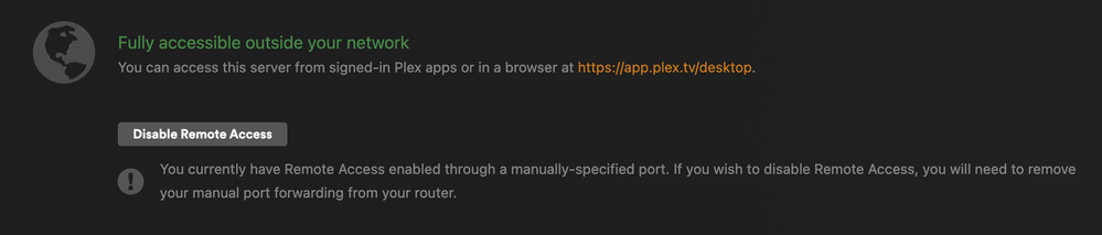

Under remote access on your PMS what do you see for this:

Re: Hub 2 stopped allowing remote plex connections
I have the always use this ip selected.
and this is what i see with my ip's blocked out

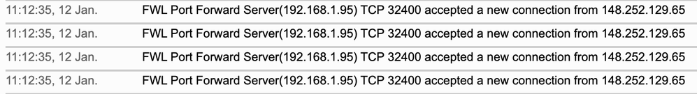

Have you looked in the log for the firewall to check you're getting the connection hitting the firewall?
This is what I see if a connection hits my router:
Nope i cant see amything like that in the log.
I have just noticed that my private ip address does not match the private one in plex.
prewski
Posts: 5
Registered: ‎12-01-2026
So after a good dig around i found a vpn had been put in and turned on.
All is back to normal now.
