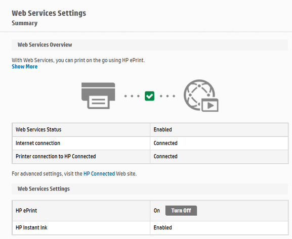

It is very frustrating, if it helps this is my web services page.
Dan.

I think it highlights the problem right there.
Where you have a green tick on the graphic I have a red minus
And under 'Printer connected to HP' I have 'Not connected'
just printed out two documents of 11 pages each and the wretched HP Ink overview page still says it can't connect to the printer despite having already adjusted the pages used figure by 22.

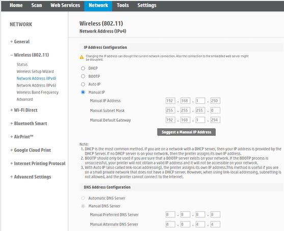

When switching to the Hub Two did you reconfigure the wireless name to be that of the previous Hub?
Are you using DHCP or manual IP settings on the printer, I would set them as below.
Maybe try a factory reset of the Hub using the pin hole at the back? Using a paper clip hold in for at least 20 seconds and release when the light goes out or turns green. The will put the Hub back into it's default state and clear out any erroneous settings that may have occurred. The Hub should auto connect with your broadband user name and password, but as a precaution make sure you have note of them. Do not restore any previous backups as this may have a corruption which would be restored to the Hub.

Dan, can't remember changing the wireless name when switching to Hub 2
although now PLUSNET-N8C2H2 and I think it was different before
my settings identical to your screen shot
did a factory reset on the hub but nothing changed.
we must be running out of things to try!

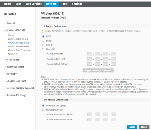

Another change worth trying is to bypass using plusnet DNS, if you click on manual as seen below it will display the current network details, you printer would not be the same IP address but the mask and gateway address should be the same as mine. Make the DNS settings to use google 8.8.8.8 and 8.8.4.4 don't forget to save the change. I would suggest power cycling the printer after the change.
Dan.

Hi Dan
nice to know it isn't just me, I think!
no, don't use Safeguard
changed those settings as suggested and power cycled the printer
