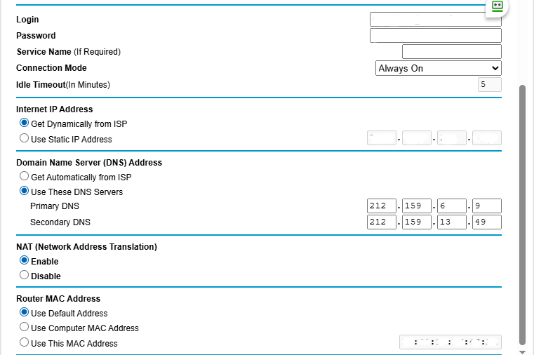

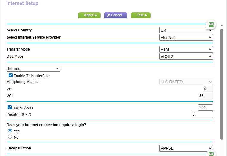

Actual config In addition to @Baldrick1 comments.  (If mods release pics)

Thanks - but they haven't released them!

Re: Hub 2 and reserved IP addresses
Let's try an attachment :
