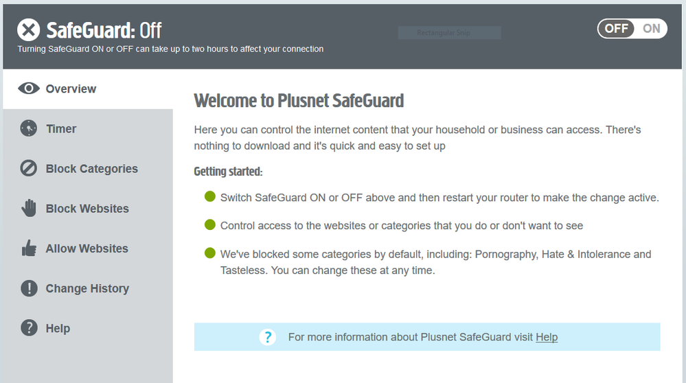

Have you looked in to using our Safeguard service? https://www.plus.net/home-broadband/safeguard/

The Safeguard service covers some of what I've been using with the other DNS provider, and will certainly cover me until such time as I can sort out a long-term solution, which seems to mean buying a third-party router.

Stupid question - it seems that the Hub One has locked DNS server addresses. How do I go about changing this to access the Safeguard DNS addresses?
Re: How to change the DNS server setting on a Hub One
29-07-2016 5:25 PM
You don't need to do anything on the router, if you follow the link I've given previously this will apply Safeguard to your account.

Yep, looked at all of that first. Done as instructed. Hub One is still accessing 212.159.13.50 and 212.159.6.9 - not 213.120.234.42. Have switched off/on, waited two hours etc etc etc
