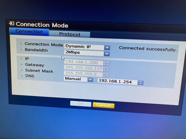

Sorry guys, I've misinformed you, my mistake for doing this in a rush and the DVR is in another room to where I can log into the router. I mistyped. working from home today so much more opportunity.
netmask is 255.255.255.0 on both the router and the DVR.
Its the gateway that doesnt match. The DVR changed gateway to 255.255.255.127 when we moved the settings from Static IP to Dynamic IP yesterday and cannot now be edited by me.  Router says my gateway is 195.166.130.254.  (I had previously matched these gateway settings in DVR and router)
@salcalvert well , they're both wrong!
The gateway you see on the router 195.166.130.254 is the router gateway to the internet. The gateway the DVR should have is the gateway device to get from the private 192.168.1.x subnet to the internet, it should be the router address 192.168.1.254.
Where the router is getting 255.255.255.127 from , I have no idea.
I suggest we switch back to static IP on the DVR with the following settings
IP 192.168.1.200
Gateway 192.168.1.254
Subnet mask 255.255.255.0
DNS 192.168.1.254
