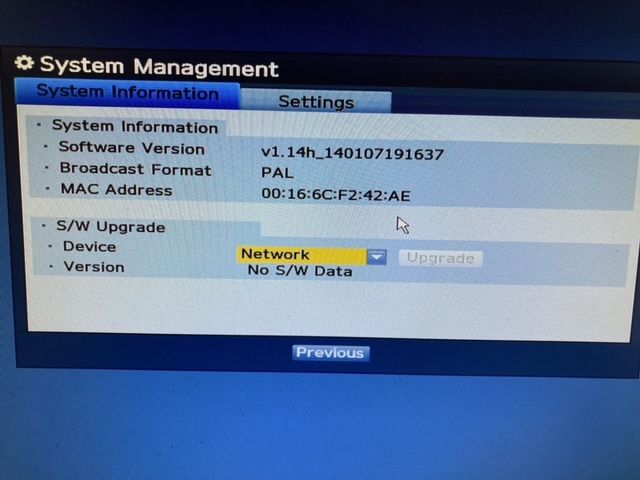

It would be useful to check that the DVR can access the 'outside world' , can you use the S/W Upgrade function in the System Management to check for internet access. Looking at the manual , you should be able to select Network to check for upgrades, hopefully that will cause the DVR to attempt internet access to check for any new firmware?

@MisterW It would be useful to check that the DVR can access the 'outside world' , can you use the S/W Upgrade function in the System Management to check for internet access. Looking at the manual , you should be able to select Network to check for upgrades, hopefully that will cause the DVR to attempt internet access to check for any new firmware?
This is an option in the menus and "Network" is selected as standard I cannot change this (no dropdown options), and the "update" button isnt accessible.
It could be nothing but I don't like the fact it says 'No s/w data' , that could imply it can't contact the server to check...
