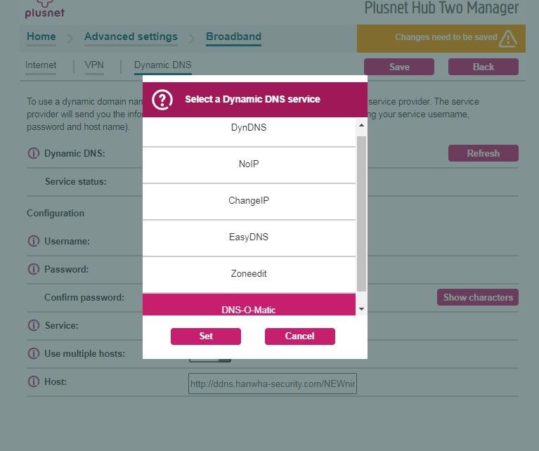

Hi everyone, new user here, just moved to Plusnet and hoping I might be able to get some help from you experts, since Plusnet support are unable/untrained/unwilling to help.
I have used a dynamic DNS to connect my phone to my home security cameras for years, worked great and it's a huge help for the general anxiety of where we live, elderly family members, etc.
Have just moved to to Plusnet fibre (which is fast as greased lightning so no complaints there) but forced to have a new router and struggling to set up my cameras because my dynamic DNS provider wasn't one of the 6 options offered in the Hub 2 router. (Was still able to access cameras when I was at home tho, using internal network viewer).
Plusnet support weren't able to advise what to do regarding the Dynamic DNS issue, but suggested I could have a static IP address for a one off £5. Little knowledge is dangerous I guess but I thought this might move me forward in the issue so said yes, however now I'm struggling to understand how this changes things for me in the bewildering settings (and now even my internal viewer no longer works).
I know I need to turn on port-forwarding, I have set up a rule for the internal ports, and one for the external ports but doesn't seem to be making any difference.
I get that I'm probably asking really beginner level questions, but does anyone have any experience here?

I cant set everything up as "exactly the same" as before as I was forced to take a new router and the internal program appears to only offer the 6 options shown below for Dynamic DNS providers.  Are you saying somehow I use one of those but insert myaccountname.plus.com somehow?   I had thought I would be now looking for some settings outside of the realm of dynamic DNS.
