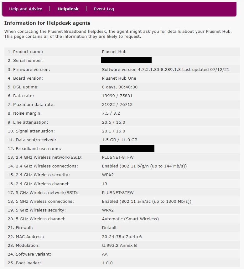

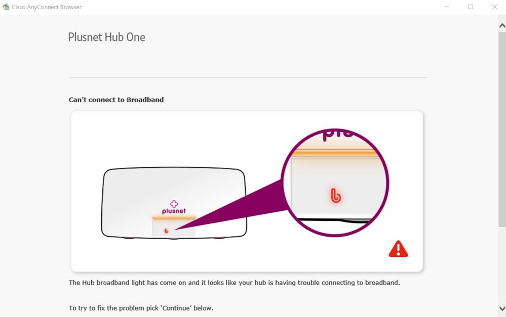

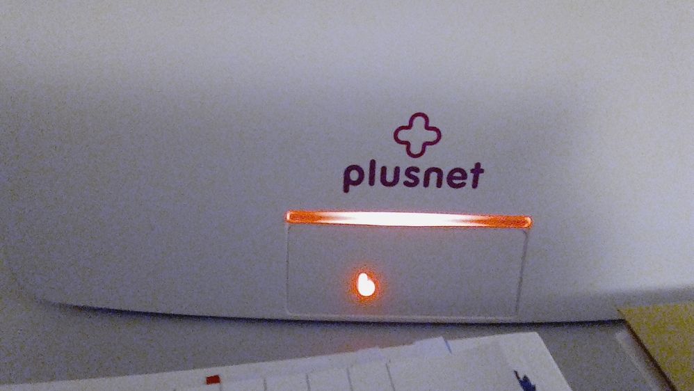

Just some of the drop outs / disconnects:
11th Dec 12.23pm, with b light on
12th Dec 10.57am, with b light on
12th Dec 5.56pm

Yep, you're dropping the PPP connection on a fairly regular basis - too regular, to be honest.  I'm also a little suspicious of your D/L SNR margin of 3dB - I know you line and signal attenuations are very low, but I wonder if that figure really ought to be 6dB?
Mustrum
Posts: 1,181
Thanks: 1,108
Fixes: 81
Registered: ‎13-08-2015
Re: Fibre broadband keeps dropping, router light goes orange
You still have good speeds, and one or two drops a day may not be enough to be classified as a fault or get investigated.
You could ask PN for an updated Radius Graph to get a better view of your lines performance since last time.
Posts: 17,660
Thanks: 8,987
Fixes: 383
@Mustrum I agree @andyt1970 still has good speeds, but should a line really drop this often, bearing in mind it has been doing it in the test socket - eliminating all home wiring? I don't think so, somehow.

Thanks guys for the continued replies / help. More than Plusnet are doing Sad
So, because I have so many dropouts / disconnects all the time, especially during the working week (our team were made remote workers 6 weeks before COVID-19 arrived and we were sent home permanently), I find myself working late on a Sunday night instead of relaxing with my family doing my yearly Impact (personal review). That should say trying as I had 3 disconnects using the works laptop on wi-fi  here in the kitchen trying to do that.
This is unacceptable. I'd pay the early exit fee with Plusnet, and jump ship to someone else, but if it's a BT Openreach / exchange problem what's the point? This sucks big time and I do feel I am being brushed under the carpet. God, it's past midnight now and I'm still working, something I should have been able to fit in during a normal working week but can't as I get disconnected then logged out my work, then have to wait 15 minutes before I can log on again.
Sunday 12th, 10.38pm
10.50pm
and
11.33pm
Goodnight 😠
