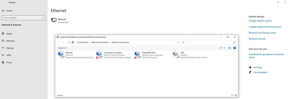

Just found the order receipt for this desktop PC and there is actually a built in PCI (?) wi-fi card inside, could this be interfering?
Just want to connect it to the router via a reliable ethernet connection......

Re: Fibre broadband keeps dropping, router light goes orange
Thank you so much, I/we could cry as you seem to be the only person acknowledging there is something not right.
If it  has a Wi-Fi card, try it with that, especially if the Hub is in the same room - if it isn't too good, you can always go back to Cat6.
The Wi-Fi card shouldn't interfere if you are connected by ethernet, but is there a way of checking whether it is in an active state - I'll have to go back to the Windows machine if you ask 'how'?'

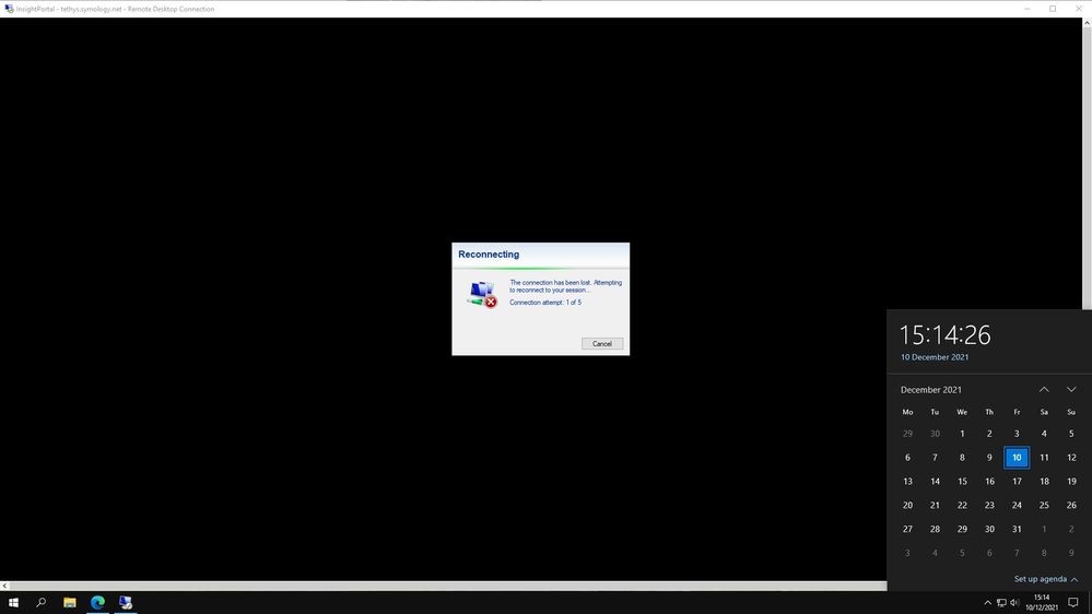

3.14pm another drop, now logged out of work for 15 minutes. Orange light on router, just gone blue again 😒

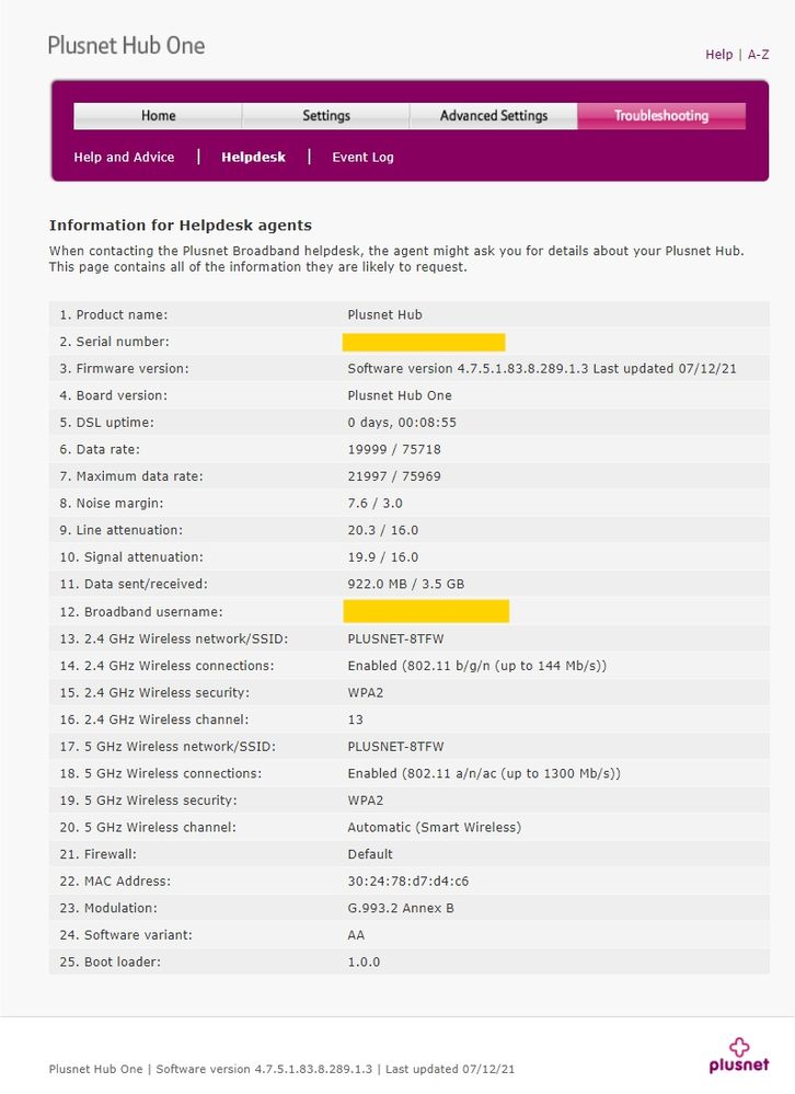

Anything in the logs, Andy - LAN or WAN?
15:15:35, 10 Dec. (58101.330000) WAN operating mode is VDSL
