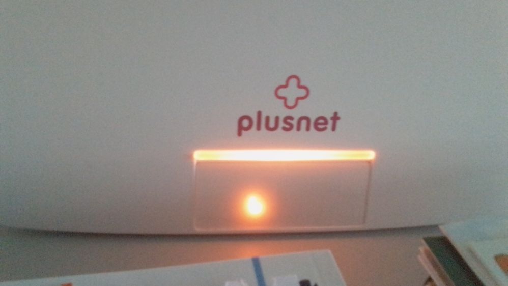

Fibre broadband keeps dropping, router light goes orange

Re: Fibre broadband keeps dropping, router light goes orange
@andyt1970
PPP LCP Send Termination Request [User request]
PPP is Point to Point Protocol
LCP is Link Control Protocol and it's decided something is wrong with the connection and closed it.
Unfortunately you do have a line issue, you can do a GEA test but it is unlikely going to find the cause, most likely noise on the line, a pop or crackle would be enough.
Agreed @Dan_the_Van , but Andy has been having this issue for weeks, and AFAICS, no-one has done much other than try and paper over the cracks.
Just some of the drop outs / disconnects:
11th Dec 12.23pm, with b light on
12th Dec 10.57am, with b light on
12th Dec 5.56pm

Yep, you're dropping the PPP connection on a fairly regular basis - too regular, to be honest.  I'm also a little suspicious of your D/L SNR margin of 3dB - I know you line and signal attenuations are very low, but I wonder if that figure really ought to be 6dB?
Mustrum
Posts: 3,704
Thanks: 1,108
Fixes: 81
Registered: ‎13-08-2015
You still have good speeds, and one or two drops a day may not be enough to be classified as a fault or get investigated.
You could ask PN for an updated Radius Graph to get a better view of your lines performance since last time.
Posts: 24,874
Thanks: 8,909
Fixes: 380
@Mustrum I agree @andyt1970 still has good speeds, but should a line really drop this often, bearing in mind it has been doing it in the test socket - eliminating all home wiring? I don't think so, somehow.

OK, @Mustrum , I'm not arguing with you, but if I saw that many PPP drops in that time on my line, I would be playing merry hell - as I had to a couple of years back when I was on ADSL and my line would not stay stable for more than a day. The OPs issue probably won't be the one an SFI finally located and fixed for me, but I had to fight to get PN to acknowledge there was a major fault outside my control.
There's plenty of drops on those two log files - and they shouldn't be happening - IMHO. A Radius log would be revealing, I agree.
