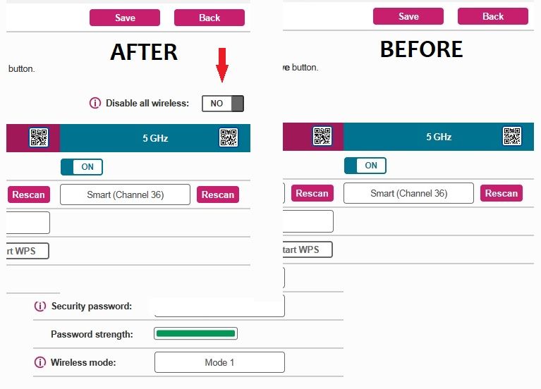

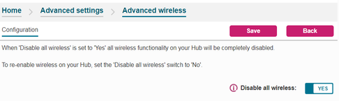

@ManicOrganic - switch your Hub Two off and back on.
When it comes back up, you should find a toggle under the Advanced Wi-Fi settings that will achieve what you desire.
Posts: 4,707
Thanks: 3,023
Fixes: 143
Re: Disabling WiFi on Hub 2
@ManicOrganic
Once rebooted you should see  in Advanced Wireless
HTH

Pleased everything has turned out well, don't forget to click save when you changed the switch to Yes.
Dan.
