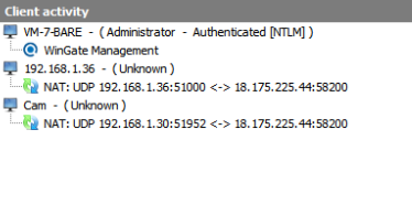

I've had a quick look but I must have set this up ages ago...........
Looks like I have a Reolink Account and all cameras are registered to the account. Windows desktop, iPad & iPhone use the Reolink app. so an educated guess:  Camera's connect to Reolink servers, external users also connect to the Reolink servers, connection between camera and user made. Can't prove this but I'll try to find a way to monitor outgoing camera traffic
Champnet
Posts: 3,326
Thanks: 1,305
Fixes: 21
Registered: ‎25-07-2007
Re: Checking UDP Ports are open
Just to confirm there is a permanent connection between cameras and remote servers
That's quite common as outgoing connections are not often blocked by a firewall and so if the camera makes an outbound request to a server that is not blocking incoming connections and the client so also makes an outbound connection to that same server they can both relay data to each other without the worry of firewalls and ports.
