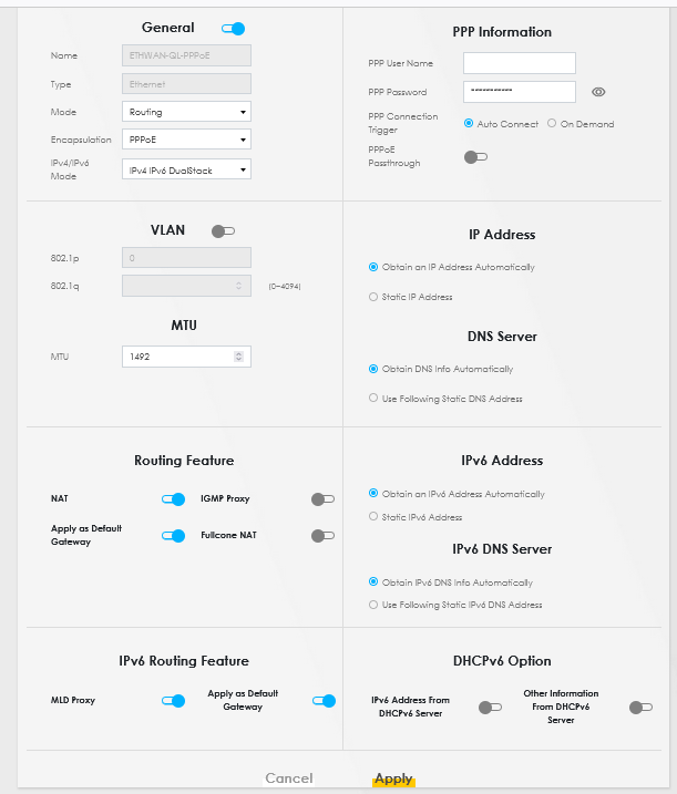

Re: zyxel ex3301-t0
WAN Interface screen, I think

Re: zyxel ex3301-t0
I'd try changing the IPv4/IPV6 mode to IPV4 only, Plusnet do not currently support IPV6.
I assume you do actually have the username field set to <youraccountname>@plusdsl.net and that you've just redacted it for the post ?
If that doesnt help then try looking at the system log, probably category WAN ( or maybe PPPoE) for a clue as to whats happening. If you need help analysing it , then export it and post it here

Re: zyxel ex3301-t0
Changed it to IPv4 no change going to admit defeat perhaps it's locked like some phones thanks for your help

@discoverytdi if its allowing you to change the WAN parameters , particularly the username/password , then its unlikely its locked.
