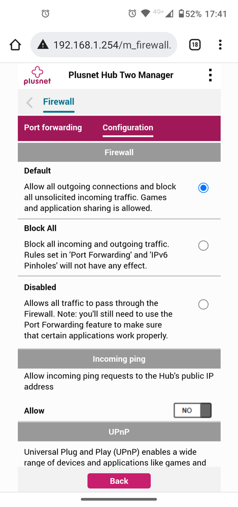

I'll try and attach pics of settings on DVR and the Hub 2. On the Hub are internal and external ports but on the DVR the ports are labelled HTTP and Server. Also what firewall setting do you use?

Also there is a broadband firewall found in the member centre which may be set to High which will prevent port 80 connections, set to Off. I beleive the firewall is found in Broadband section.

To be clear I am referring to the firewall found in the members centre navigate from Home >Broadband >Broadband Firewall
There should be no need to turn off the Hub Two firewall off.

Firewall was set to Off already.

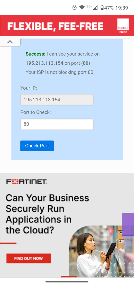

I've opened  Ports 80 and 6036 and checked on the website that they are indeed open as per pics
But still no Online connection 🤷

The good news is canyouseeme works show the connection can be made, this means the port forward rule are working.

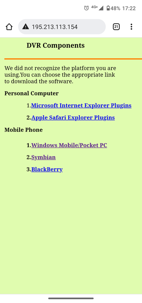

I can view on computer via Chrome set to IE mode but if I try it on mobile daScreenshot_20221015-172242.pngta this is what I get.

Looks like the DVR server does not recognise the operating system your mobile device is running. Not supprising as it (DVR) is old.
Maybe see if there's any support for it.

Thanks Dan, I'll get in contact with them but don't hold out much hope seeing it's a 10 year old system! 😀
