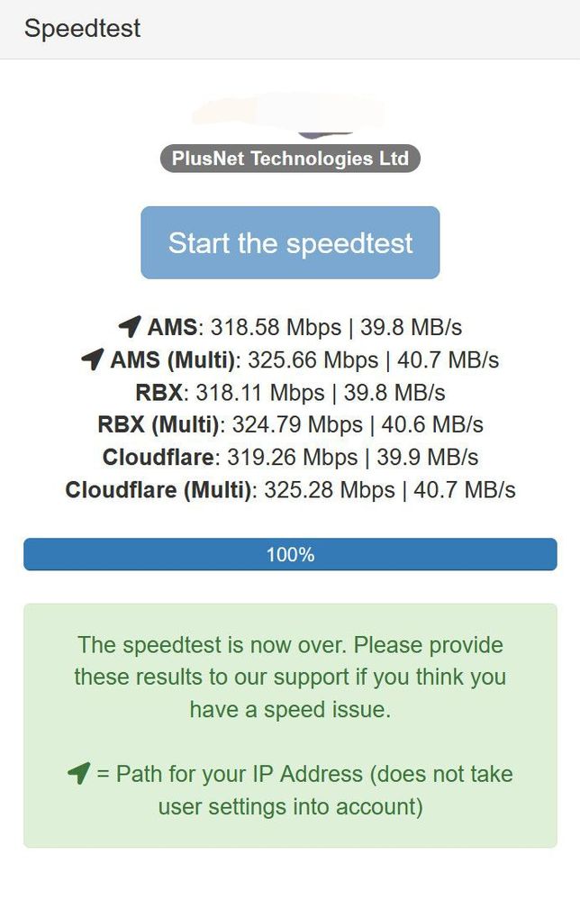

I am trying to get my Asus dsl-ax82u working with Nordvpn on the router I have connected by vpn fusion and I can only download at 60mbs turn the vpn off and I get 300mbs I know its the router because I have tried nordvpn app on my android
And get a speed of 260mbs with using the app.
Does anyone know how to get it working ok so I can connect all my devices to through my router, I dont know a lot
about this topic so go easy on my.
Thanks Steve
