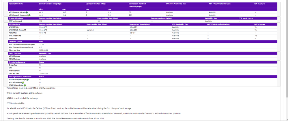

OK, then post the results after putting your phone number in the BTW DSL checker. This will show what your line is capable of. Make sure you hide your phone number.

If i had to make a guess as to what one you mean, fttp on demand is 330 down and 50 up.
Just incase its not i've attatched an image.

FTTP on demand is more of a business product and will cost lots to install.
But as per my earlier post, your line is only capable of 46Mbps at the most - VDSL line.
You are getting speeds within your estimates as per my first post.

While I agree with the above^ and I can see your speeds are within expectations for how long your line is to the cabinet (the green box in the road), our advanced testing (known as RRT internally) is showing a line issue impacting your service in some way, so we'd need to arrange another engineer visit to investigate further.
Can you reply to the ticket you've raised online Here with two or three timeslots when you'll be free for a visit? As you may know, the available timeslots are weekdays (and occasionally Saturday's) 8am while 1pm, or 1pm while 6pm. We'll then book the appointment for you as soon as we can.
I can't guarantee though your speeds will increase further when an engineer's resolved the line issue, so I'd like to offer you the opportunity to move back onto your previous fibre package and contract. If you'd like to go ahead, please let us know by replying to that ticket^ and we'll arrange this. Alternatively, I'd ask the account holder to call us on 0800 013 2632.
