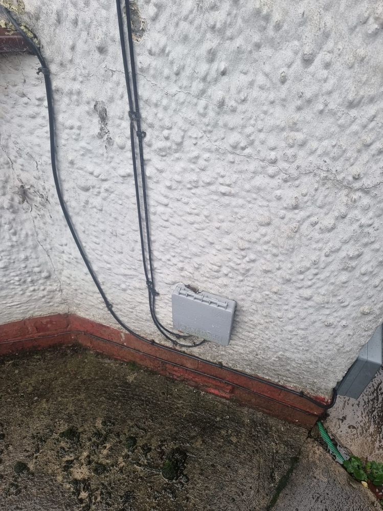

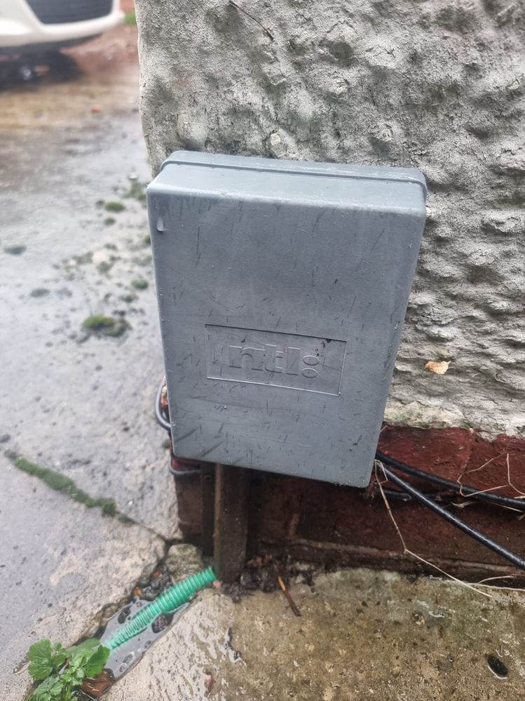

I checked outside and saw these 2 boxes on the outside (pictures attached). The second one does say "open reach" on it. So it seems they did provide a connection here in the past. The wire from this is entering the front room on my flat from outside, but there is no wire on the inside, probably blocked during repaint. It is also going up to the other flat.
WhatsApp Image 2025-11-14 at 14.33.36_1986e008.jpgWhatsApp Image 2025-11-14 at 14.33.36_da30fb16.jpg

@greathassan well the first one is an NTL cable box, so nothing to do with fibre.
the 2nd one MIGHT be a Fibre CSP (customer splice point) but do any of the cables from that go into your flat ? it looks like one cable might be from the pole and the other might be going up to the upstairs flat.
If that CSP was for your flat I'd expect a cable (with a green connector) inside the flat opposite the box on the outside wall ?

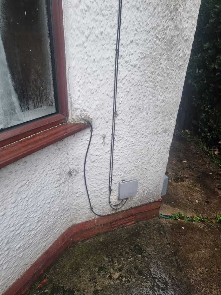

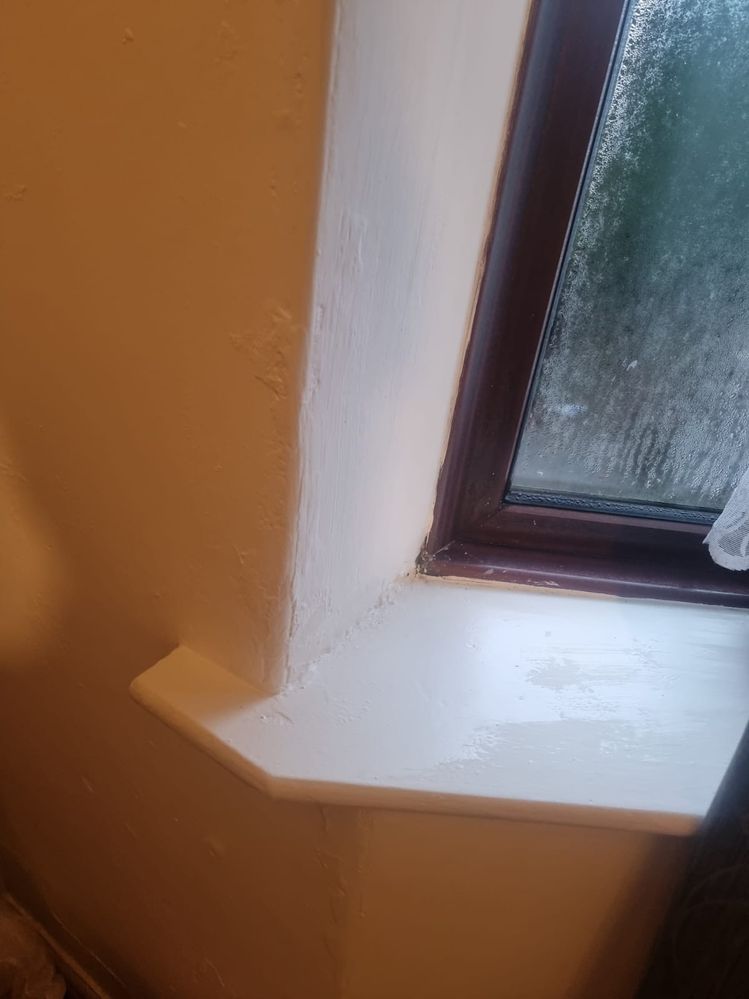

@MisterW There is no cable from this box inside the flat. I am attaching a few pictures below to show this:
In the below image, it looks like the cable is entering the ground floor flat near window and going upwards towards the upper flat.
In this image, this is the inside of the room where the wire looked like it is entering, but there is nothing on the inside.WhatsApp Image 2025-11-14 at 14.52.09_dd1fa8d4.jpg

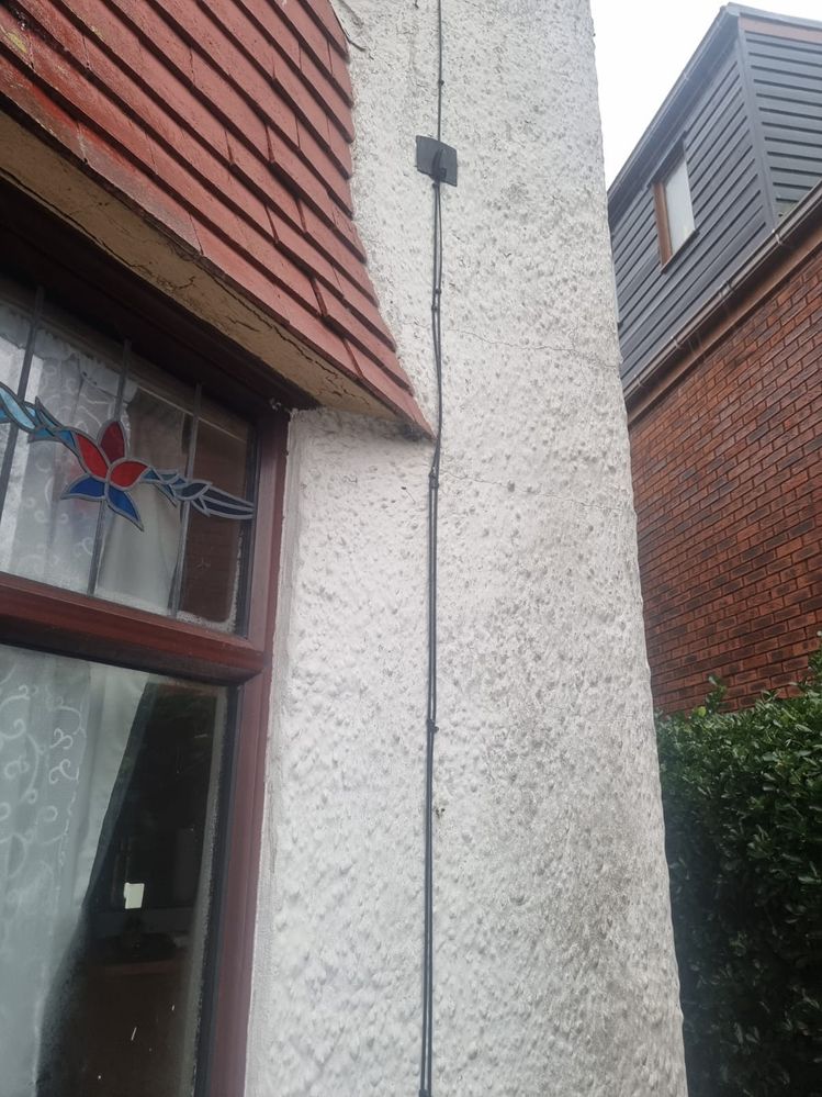

Below image shows the wire going up towards the top flat. Or it might be the wire coming from the pole to the box.

@greathassan that cable going in near the window looks like its coming from the NTL box rather than the Openreach one ? is that correct ?
Looks like the Openreach one is only feeding the upstairs flat ?
