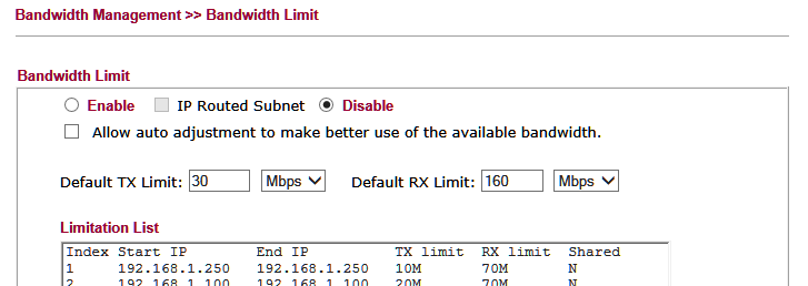

QoS per se is disabled, but the setting I was referring to is as shown below under Bandwidth Management which I did have enabled and set to 160 Mb/s (previously 79 Mb/s), I've now disabled it as shown which may have made a slight difference as subsequent speed tests were slightly higher.
However, I'm embarrassed Embarrassed to say that connecting my PC direct to the ONT, speedtest.net shows that my download speed is just under 150 Mb/s whilst the AAISP tester shows 155 Mb/s Smiley
