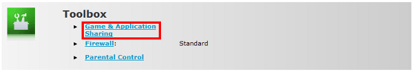

On the home page look for the toolbox section in the middle of the page and click “Game & Application Sharing”.

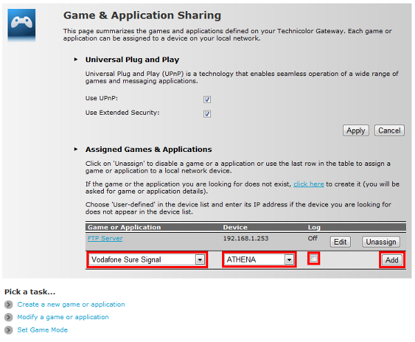

When you’re done with that we need to assign the profile to a device on our local network, to do this click the option highlighted above.
Stage Three – Assign the profile to a device
Now you have the profile done it’s time to assign it to your Sure Signal. On the game and application sharing page you will find some drop down lists, the first allows you to select the profile we created in the earlier section. Once you have found the profile you need to find your sure signal in the second drop down list, if you have any problems with your sure signal Vodafone may ask you to turn the “Log” option on. When you have selected everything click “Add” to assign the profile.
07-assignhost

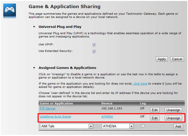

When the page reloads you should have a row on the table of assigned profiles with your selection.
08-end
This means everything is set up, if your sure signal has any problems after this then you should try turning both your router and your sure signal off and then back on again. If any problems persist your best option is to contact Vodafone support on 08700 700191 or dial 191 from your Vodafone mobile.
