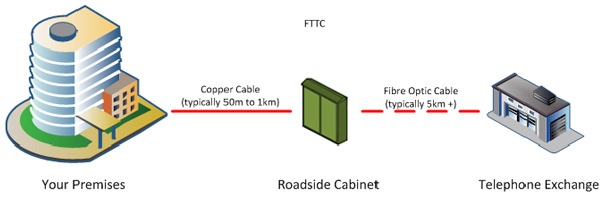

FTTC is a technology which delivers speeds of up to 76Mb. The service differs vastly from ADSL, as ADSL is a completely copper (aluminium in some cases) whereas FTTC has Fibre Optic cabling between your Local Exchange and Green FTTC Cabinet that you might see in the street.
The copper part of the network is between your cabinet, telephone pole and the cabling up and into your property. This is the layout of the FTTC network:

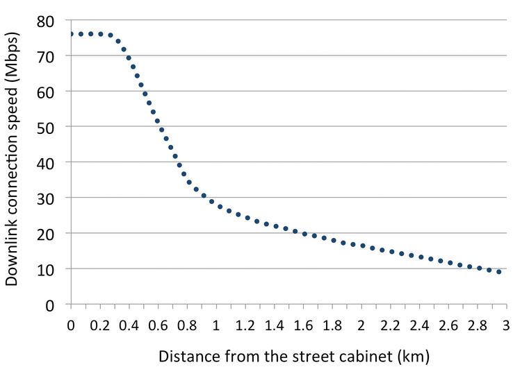

 FTTC is generally only made available to users who live within 1.5km, in some circumstances 2km from their cabinet. The shorter the distance you are from the cabinet, the faster speeds you’re likely to get. Unlike ADSL, the speeds don’t gradually get lower and lower the further away you are from the cabinet, you’ll hit a certain point where the speeds drop drastically, this is due to the higher frequency used on FTTC.
A good example of rough estimates can be seen below:

When you’re signing up, you will have been presented with a speed estimate, this is generally sound, however, there will be times where the estimate can vary, very much dependant on line conditions; each and every line is different. We aim to provide you with a service that is around the speed of the estimate you were provided with.
It’s important to remember that the estimated speeds are not a guarantee and is a guideline and is very much an estimate. If, in the event, you’re getting lower speeds than your estimate, we’d like to know so we can help. We’ve plenty of helpful guides to help you get the help and support you need.
