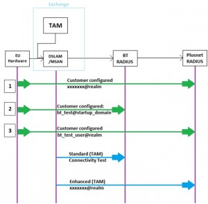

You may notice that we complete a TAM Test as part of our authentication testing. Please see the below diagram for reference:
 1. This would your [email protected] – this should be what you would normally connect with
2. If you are having problems connecting, you should enter bt_test@startup_domain with the password as: ‘test’ (without the apostrophes). This tests up to BT’s RADIUS, if you’re unable to connect up to this point, there’s a definite fault and you should enter your [email protected] and raise a fault
3. If you are able to connect with the details from 2, you should enter [email protected] with the password ‘test’ as above. If you cannot connect, please raise a fault. If you are able to connect, try your [email protected] details again, if you’re not able to connect, it’s likely there’s a problem with the configuration on your account on our side – you’ll need to raise a fault so that we can get that looked at for you.
The TAM Test we run, isn’t available on all 20CN circuits, therefore, the test logins that you complete can be crucial. TAM tests are available on all 21CN and FTTC circuits. The TAM test allows us to connect as if we are trying to connect as you. We can test up to BT RADIUS and we can run an ‘Enhanced TAM Test’ which will allow us to try and replicate you connecting with your ADSL details.
