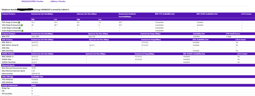

I assume FTTP isn't on the horizon. This would bypass the Master Socket.
The checkers ar in the process of updating following the announcement of more Exchanges to be done. It might just be worth a check.
https://www.broadbandchecker.btwholesale.com/#/ADSL (you're looking for WBC FTTP in the left hand column)
https://www.openreach.com/
dawson
Posts: 33
Thanks: 5
Registered: ‎23-05-2010
Re: Cost to replace BT Master socket
hmm, it looks like it is available - so that would bypass this whole issue!
I still have around 18months left on my current deal.
I will need to consider the implications of losing the landline/telephone number.
Posts: 5,934
Thanks: 2,216
Fixes: 118
@dawson
Yes, It's available. An entirely new fibre optic cable is run to your house terminating at an Optical Network Adapter (ONT). Sometimes it comes in via the existing entry point for the copper cable, or else by a new drilled hole.
https://support.aa.net.uk/Openreach_FTTP_ONT
You do lose your landline but not necessarily your phone number, You can port it immediately after install to a VOIP provider.
PN will upgrade you at any time at the cost of a new contract. The lowest speed on full fibre is 78 down so it looks like you'd get a doubling of speed without even considering the faster products.
I would continue with the fault checking while you think about things. Two things to consider - what's you mobile signal like and is your phone number important to you.
